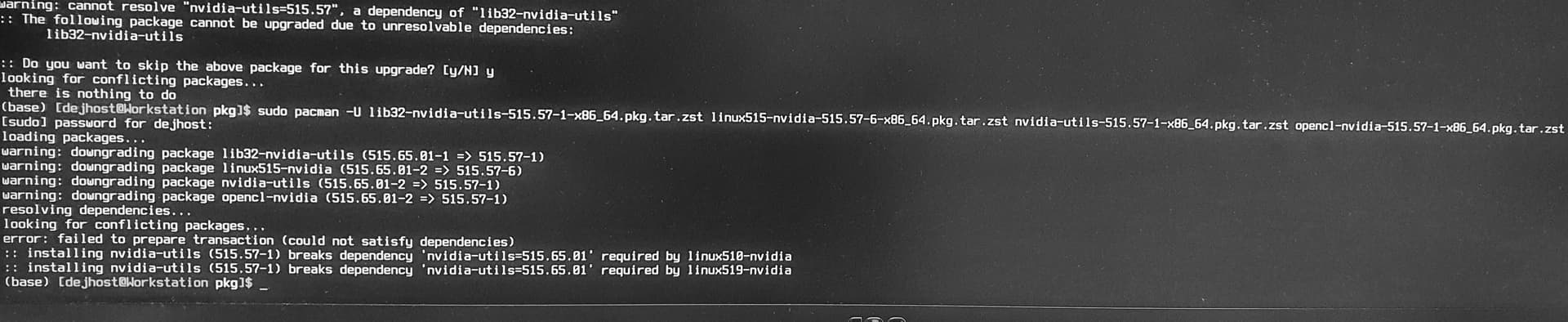

Beside the obvious error below, the package linux515-nvidia515.57.1 is not availablr. I replaced it with …7, which is available.
I need to call it a night. Back in 10 hours or so.
I ended up uninstalling linux-kernel 519 and 510, booted 515 and downgraded the packages described above. I can log into gdm-GUI now.
