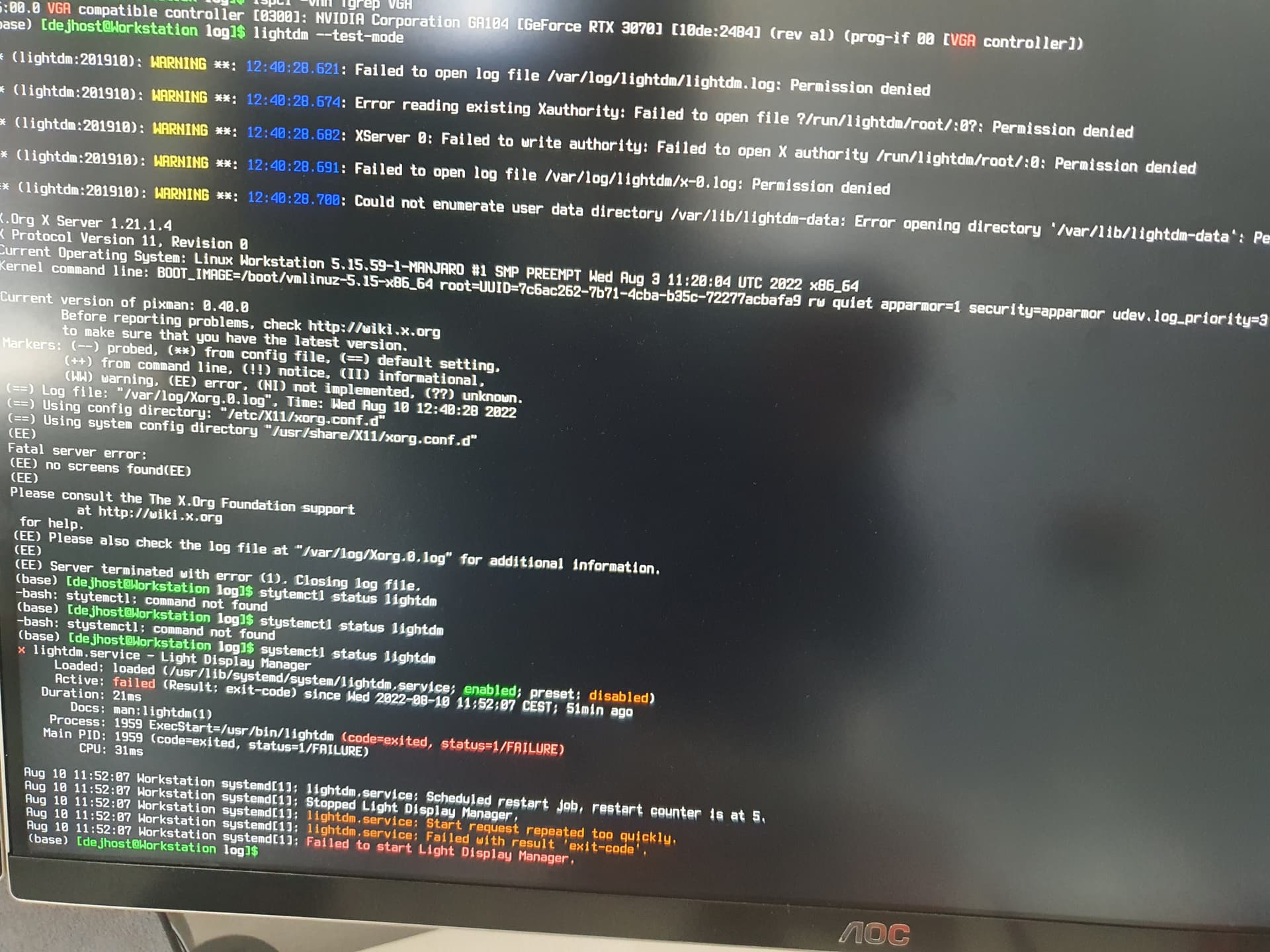

I uninstalled the nvidia-drivers (along with some conflicting packages and files), and I am now back to my GUI. When I re-install nvidia, I am back to the problem above.
Does anybody how I can resolve this, ending up with nvidia installed AND a GUI?
An older kernel? An older nvidia-package?
@anon89812132: unfortunately, I read you message too late. Nethertheless, I will post details of my “final system” below.
I ended up trying to combine various linux-kernels with the nvidia-drivers.
Kernel 5.10 and 5.17 failed, leading to the above described problem with lightdm (after I installed nvidia). Eventually, kernel 5.19 seems work. This is what I am running now.
sudo mhwd -f -i pci video
is how I installed the nvidia drivers.

Linux Kernel 5.10 and 5.15 failed in combination with nvidia drivers. I have not tried 5.17.
After another update and a restart, 5.19 fails, too.
I uninstalled and installed the nonfree nvidia driver following the wiki, but same result. If I run the nvidia-settings, it complains about a missing key file:
I’ve uninstalled the nvidia-driver and started manjaro with kernel 5.19 prior fetching the logs:

This failure to start lightdm was the reason I abandonded it more than a year ago and moved to GDM which works flawlessly. And I, like you, tried many different ways to make it work. If you can’t make it work, you can try GDM. There’s one pro about GDM over LightDM - you don’t have to edit any additional system files in order to have autologin.
I installed the 470xx as you instructed. Unless the usual rm /usr/lib/libnvidia-egl-wayland.so.1
everything went fine. The lightdm.conf already had the right entry.
After reboot, I get the same failure message from lightdm.
So I uninstalled the driver again.
(base) [dejhost@Workstation ~]$ journalctl -b0 -p4 --no-pager
