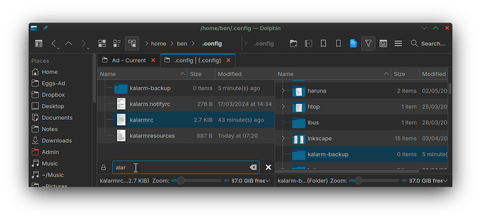

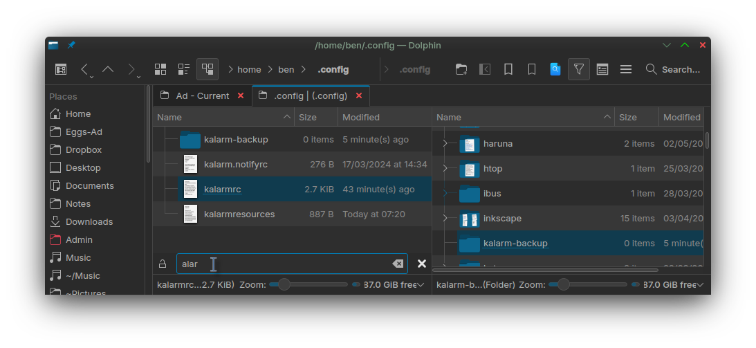

I tried uninstalling and reinstalling. Not really much else to try when the app gets broke by update and wont even launch :man_shrugging:
EDIT:: Issue was resolved by manually clearing files by searching within folders indicated in post marked as solution.

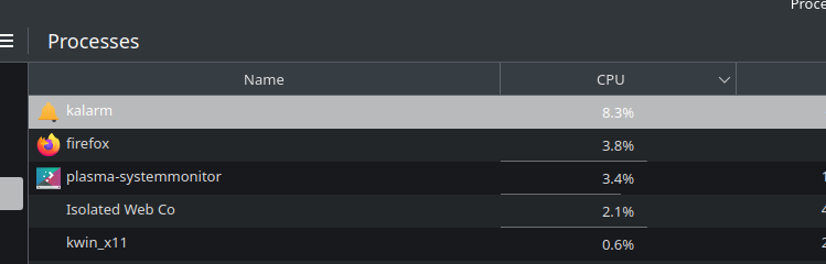

in my up to date VM, when I open a terminal and type
kalarm
and then hit enter
I get this:
kalarm
MESA: error: ZINK: vkCreateInstance failed (VK_ERROR_INCOMPATIBLE_DRIVER)
glx: failed to create drisw screen
org.kde.pim.kalarm: Kernel alarm timers not available (no CAP_WAKE_ALARM capability)
and the thing starts
Start via menu works as well.

kalarm does actually launch and runs … and uses almost 10% of CPU
It shows up in taskbar for a few seconds and then disappears but stays running.
kalarm runs properly under a new user I just created to test it.

If KAlarm works on a new user, then it’s your $USER data.
I think you’ll find ALL the files pertaining to KAlarm configuration in the ~/.config and ~/.local` folders…
This is messy, as there are a TON of KDE config files… but if you scroll past the folders in the config folder, you’ll find some that look relevant.
Now, if you do F3 to get a new pane in Dolphin, then CtrlShiftN for a new folder and type the name kalarm-backup
Then you can select (Kalarm) stuff and MOVE it across. I found ‘kalarmrc’ which I’d test on it’s own first.
Make sure you learn how to use ‘filter’ in Dolphin - press / and type ‘alar’ - and everything else vanishes :wink:
Then:
Alt+F2
LogSpaceOutEnter
Then log in and try it again.
