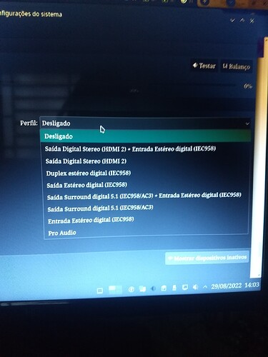

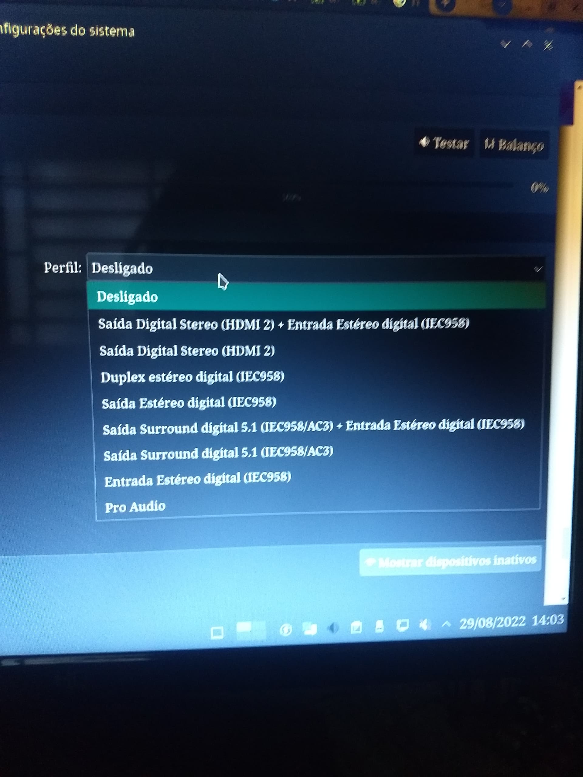

It don't recognize my headphones anymore

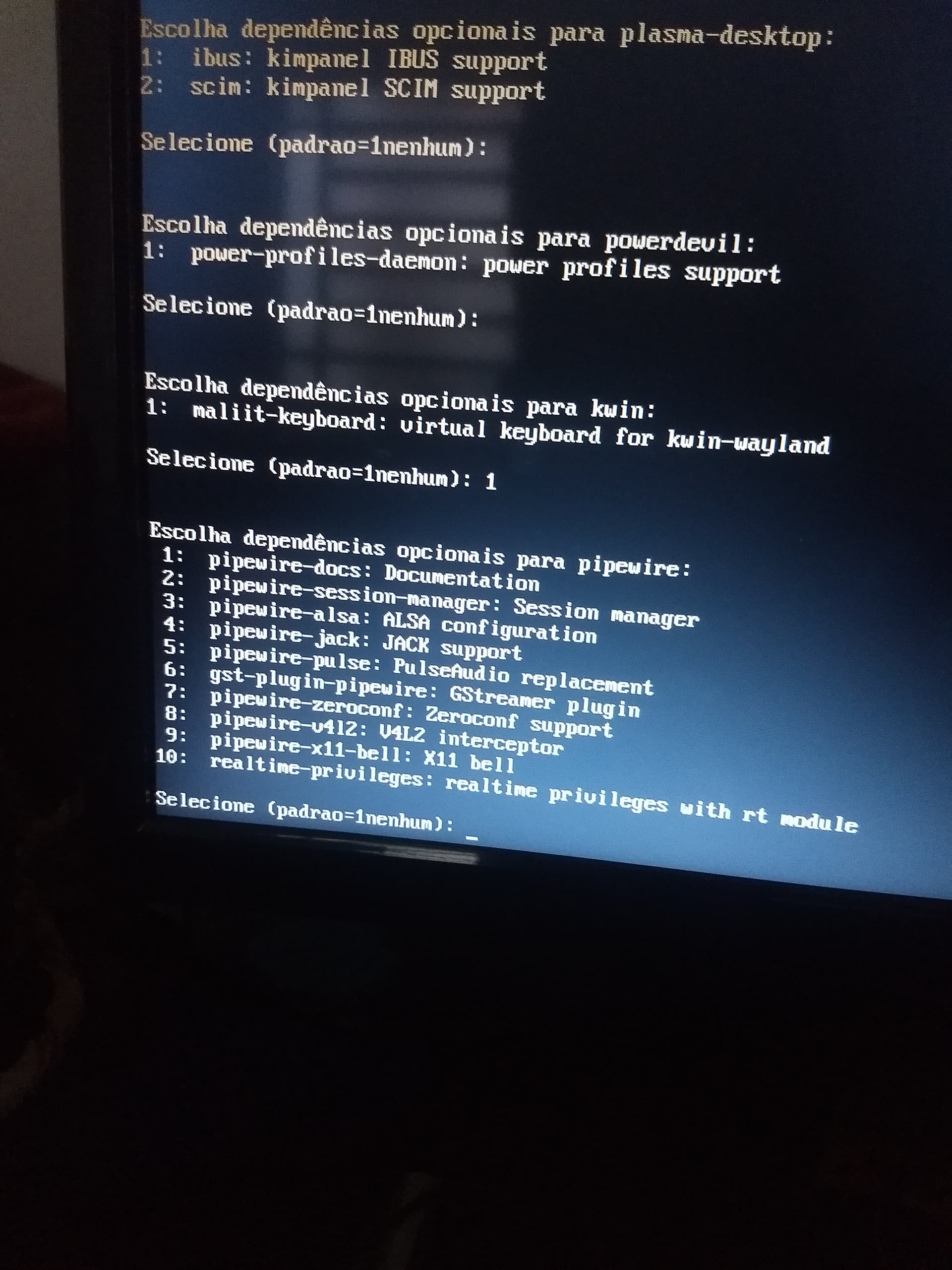

This is interesting, should I select something from here? Or “default=1none”?
Edit: about PipeWire dependencies
dont select any from pipewire, we will install it when we will replace pulse when you are back in your desktop

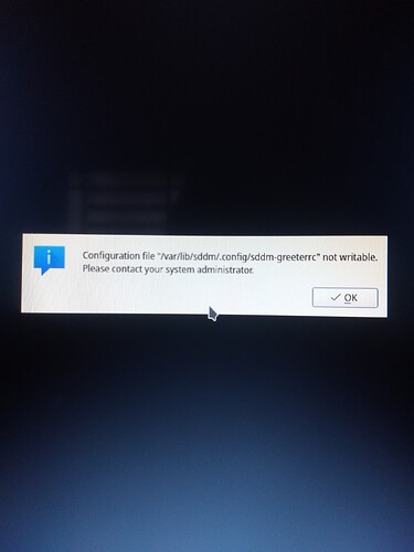

But what means this error message?
It always showed up, even before this problems with audio. But If It is not importante I can see It later.
So what we do now?(about the audio)
run this command to get rid of the configuration file not writable message:
sudo chown -R sddm:sddm /var/lib/sddm/.config

ok lets replace pulse with pipewire:
pamac install manjaro-pipewire
it will give you pulse dependency issues first, so remove them - if you are unsure, post the output from the command above here - then run again the install command, and select wireplumber as a option, reboot and test headphones
pamac install manjaro-pipewire                                                                 ✔
Preparando...
Sincronizando banco de dados de pacotes...
Atualizando AUR...
Escolha dependências opcionais para manjaro-pipewire:
1:  easyeffects: advanced equalizer and effects
2:  pipewire-jack: Jack support
3:  pipewire-v4l2: V4L2 interceptor
4:  pipewire-x11-bell: X11 bell
5:  realtime-privileges: Realtime privileges for users
Selecione (padrão=1nenhum): 5
Resolvendo dependências...
Verificando conflito entre pacotes...
Erro: Falha ao preparar transação:
não foi possível satisfazer as dependências:
- a remoção de pulseaudio quebra a dependência 'pulseaudio=16.1-1' requerida por pulseaudio-jack
In the end it says “the remotion of pulseaudio brakes the dependencie ‘pulseaudio=16.1-1’ required by pulseaudio-jack”, so I need to remove it first.

It is not detecting any of the analogical ports :disappointed_relieved:
and what exactly is the issue?
when you connect your headphones into your pc, there is no sound from them?
no, there is no sound. When pulseaudio was here it has the “analogical” profiles, and they worked for a while until stopped doing sound and always saying this was disconnected. I can’t figure what’s happening
did you selected the wireplumber during pipewire install?
