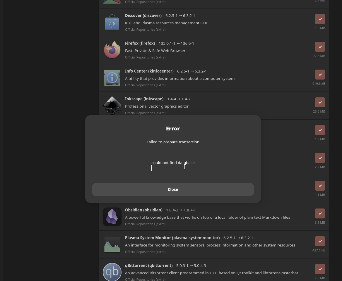

and via pamac GUI
Manjaro Linux Forum
see the pinned post at the top of the “latest” page - the link takes you there

I’m having the same problem with my laptop. I did the following which worked on my desktop but not this laptop.
sudo rm -R /var/lib/pacman/sync
sudo -E pacman -Syu
Here’s the error message I get:
Checking inter-conflicts…
Error: Failed to prepare transaction:
could not satisfy dependencies:
removing lib32-libffi breaks dependency ‘lib32-libffi’ required by lib32-glib2
removing lib32-pcre2 breaks dependency ‘lib32-pcre2’ required by lib32-glib2
removing lib32-libffi breaks dependency ‘libffi.so=8-32’ required by lib32-glib2
I’m in the nano /etc/pacman.conf file and I have the exact same command listed in the suggestion, so I don’t know what else to do or try!
