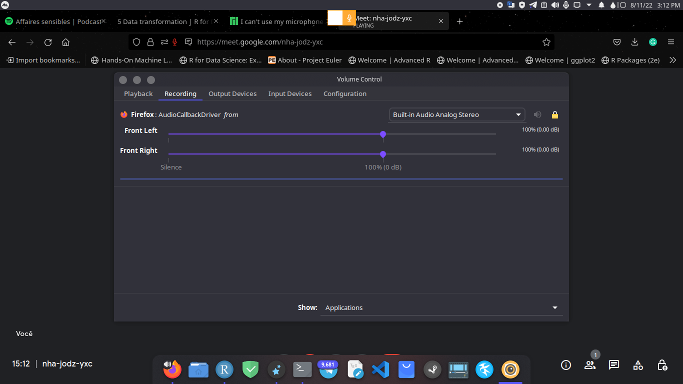

It didn’t solve the problem. When I try to use Google Meet, seems that the browser only recognizes Monitor of Built-in Audio Analog Stereo , but it doesn’t recognize my microphone. Thanks.
After starting Google Meet and allow microphone access, open pavucontrol and go to Recordings. There you can switch it. It should be saved then for the next time.
Thanks, but this didn’t work as well.

I did what you ask, but when I choose Built-in Audio Analog Stereo , it changes automatically back to Monitor of Built-in Audio Analog Stereo option.

Only thing what I think have happened: You actually didn’t choose it. Wrong click etc… I cannot reproduce it.

Simple mixer control 'Front',0
Capabilities: pvolume pswitch
Limits: Playback 0 - 64
Mono:
Front Left: Playback 64 [100%] [0.00dB] [on]
Front Right: Playback 64 [100%] [0.00dB] [on]
Simple mixer control 'Front Mic',0
Limits: Playback 0 - 31
Mono:
Front Left: Playback 0 [0%] [-34.50dB] [off]
Front Right: Playback 0 [0%] [-34.50dB] [off]
Simple mixer control 'Front Mic Boost',0
Capabilities: volume
Limits: 0 - 3
Front Left: 0 [0%] [0.00dB]
Front Right: 0 [0%] [0.00dB]
Simple mixer control 'Surround',0
Mono:
Simple mixer control 'Center',0
Capabilities: pvolume pvolume-joined pswitch pswitch-joined
Playback channels: Mono
Mono: Playback 64 [100%] [0.00dB] [on]
Simple mixer control 'LFE',0
Simple mixer control 'Line',0
Mono:
Simple mixer control 'Line Boost',0
Limits: 0 - 3
Simple mixer control 'IEC958',0
Capabilities: pswitch pswitch-joined
Mono: Playback [off]
Simple mixer control 'IEC958 Default PCM',0
Mono: Playback [on]
Simple mixer control 'Capture',0
Capabilities: cvolume cswitch
Limits: Capture 0 - 46
Front Left: Capture 45 [98%] [29.00dB] [on]
Front Right: Capture 0 [0%] [-16.00dB] [on]
Simple mixer control 'Capture',1
Front Left: Capture 0 [0%] [-16.00dB] [off]
Front Right: Capture 0 [0%] [-16.00dB] [off]
Simple mixer control 'Auto-Mute Mode',0
Capabilities: enum
Items: 'Disabled' 'Enabled'
Item0: 'Enabled'
Simple mixer control 'Channel Mode',0
Capabilities: enum
Items: '2ch' '4ch' '6ch'
Item0: '2ch'
Simple mixer control 'Input Source',0
Capabilities: cenum
Items: 'Front Mic' 'Rear Mic' 'Line'
Item0: 'Front Mic'
Simple mixer control 'Input Source',1
Capabilities: cenum
Item0: 'Front Mic'
Simple mixer control 'Loopback Mixing',0
Capabilities: enum
Item0: 'Disabled'
Simple mixer control 'Rear Mic',0
Mono:
Simple mixer control 'Rear Mic Boost',0
Limits: 0 - 3
I found the solution right here: PulseAudio/Troubleshooting - ArchWiki
You just need to modify the default.pa document.
No microphone on Steam or Skype with enable-remixing = no
system
Closed
