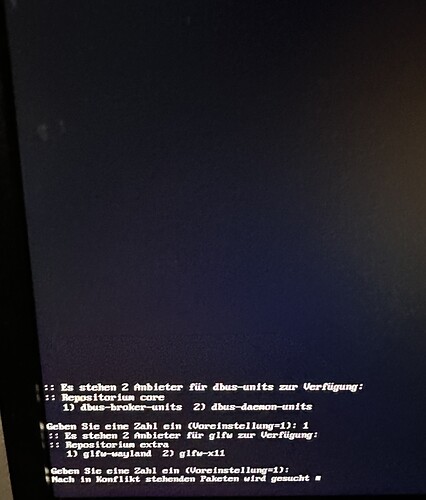

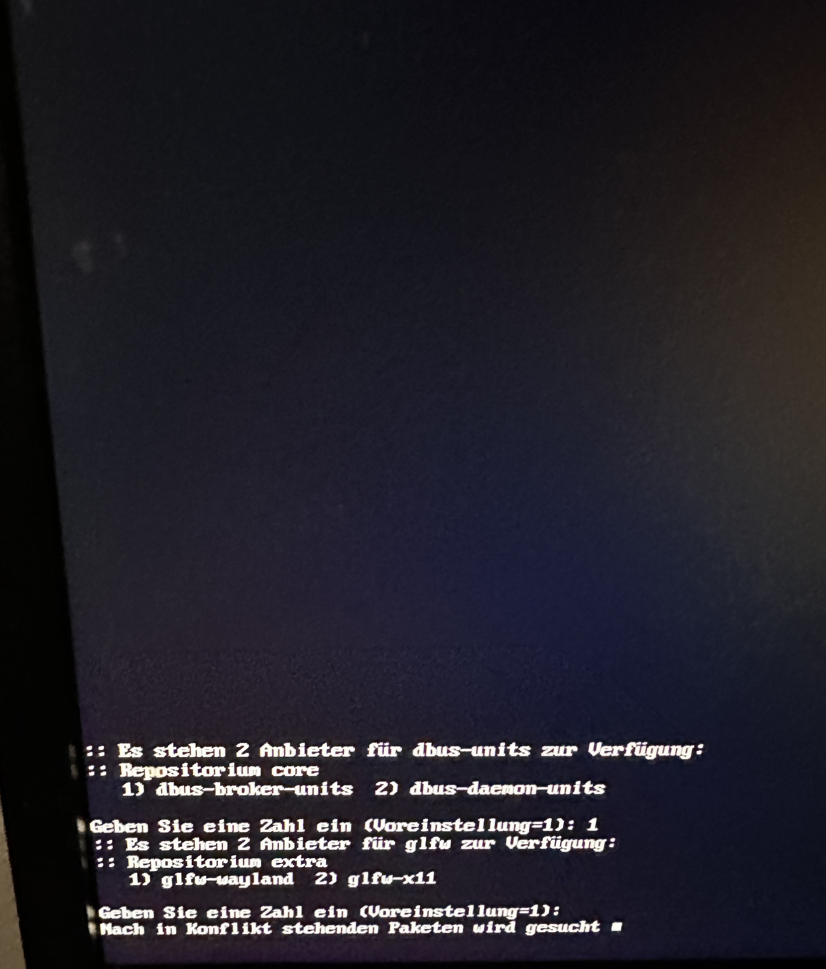

Yeah that worked, now I used the command “sudo pacman -Syu” and it asks me if I want to replace a bunch of files, I said yes to all of them, and also it asked me this.
I just chose the first one, and I got this error

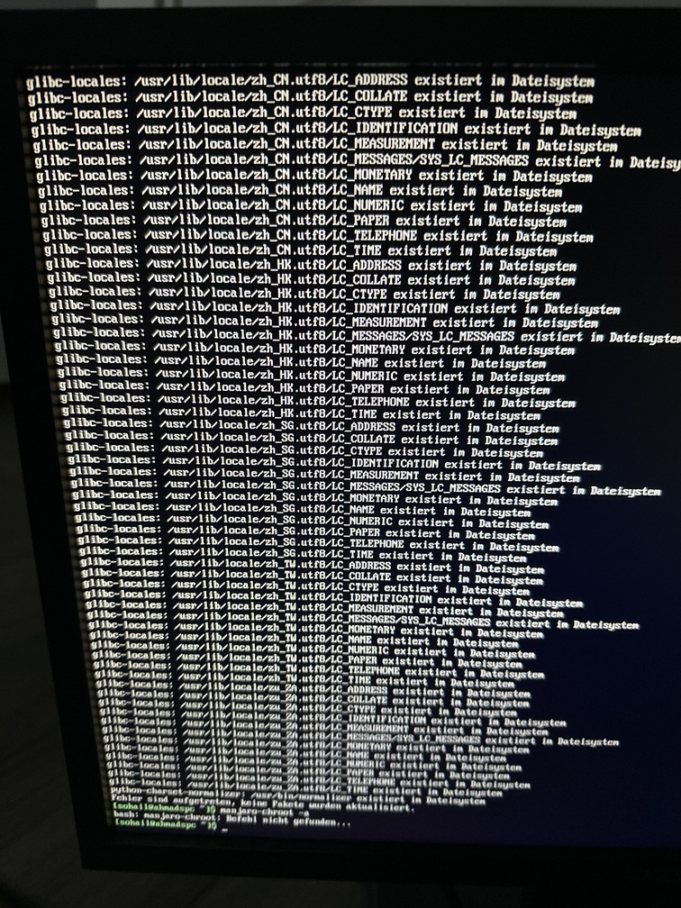

Mit dem “existiert bereits im Dateisystem” weiß ich momentan nichts anzufangen.
Wie man damit umgeht ist aber schon hundert Mal hier im Forum angesprochen worden.
Such doch mal danach - vielleicht kann auch jemand helfen.

These two seem pertinent:
sudo pacman -Syu glibc-locales --overwrite /usr/lib/locale/\*/\*
seems to be what is needed
Or this from the Arch forum thread:
sudo pacman -S --overwrite '/usr/lib/locale/*/*' glibc glibc-locales
which, in your case, should probably use -Syu instead of just -S

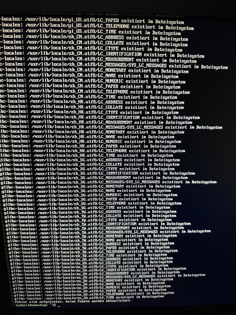

I’ve tried this but it says ”command not found”
About this, I tried both and both say the same thing:

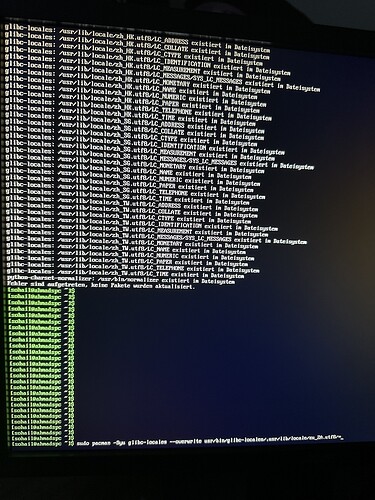

… look for the last error message as well then - re python-charset-normalizer
I found this:
If that’s the case it would have been your error from using sudo pip install ...

Ich hab das probiert hat immer noch nicht funktioniert, ich weiß aber nicht ob ich den Command richtig hinbekommen habe:
Just for the record, this thread is in the international (and thus English-spoken) section of the forum. If you’re going to insist on speaking German, then I’ll be moving it to Deutsch.
Doesn’t look like it.
One more reason to boot the live USB and enter chroot - you can copy paste instead of posting blurry photos.

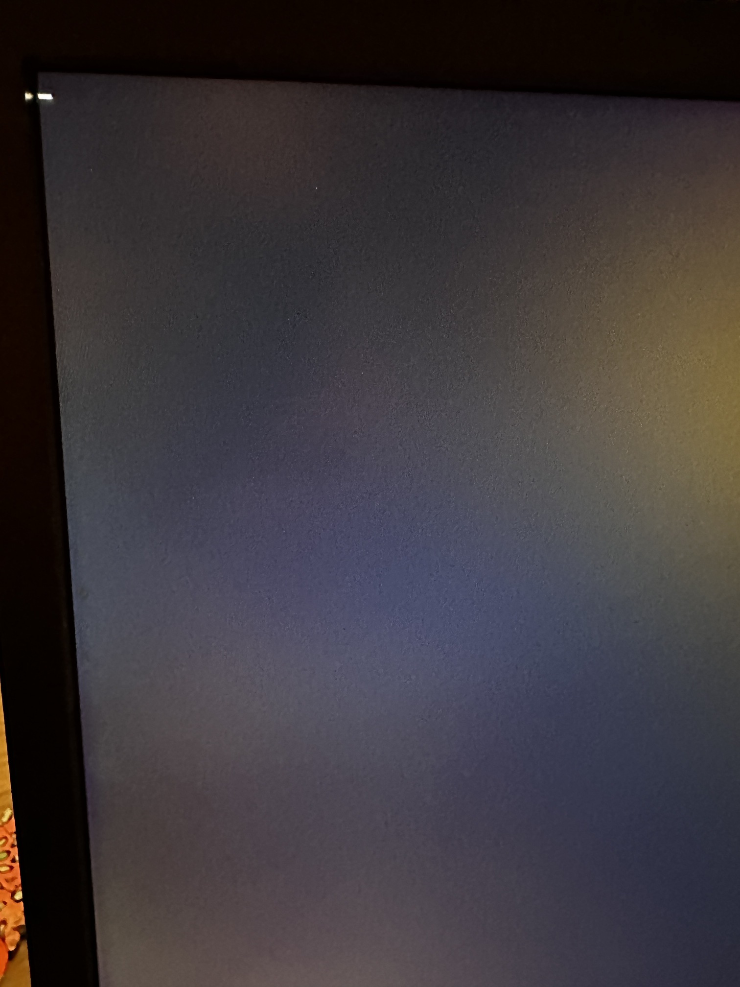

I got the same problem since the last update.
The system starts up, on TTY1, and then stuck there, instead automatically of switching to TTY7, where the login manager from your Desktop is.
You would have to manually press `ctrl+alt+F7, to come to the login.
I think it fixed it after reinstalling or update grub, not sure which one it was.
I didnt see this topic earlier to response, but its easy to fix actually.
I wonder more, why this bug did appear.
That message on that screenshot is also that one, what you see, when you simple press ctrl+alt+F1
@Sohailzm For more clarifications, you have at least 5 + 2 (12) more sessions to use, where you can switch trough with ctrl+alt+F1 - F7, TTY1 is for startup, TTY7 is, where your Desktop runs at, TTY8 would be a second monitor.
The rest is for using console commands.
