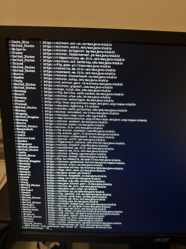

Bitte einen Schritt nach dem anderen. Erstmal die mirrors updaten, und dann sehen wir weiter.
Please take it one step
at a time. First update the mirrors and then we’ll see.
Wir probieren mal nur die lokalen (das sind weniger)
We’ll just try the local ones (that’s less)
sudo pacman-mirrors
sudo pacman-mirrors
[sudo] Passwort für andreas:
Pacman-mirrors version 4.24.0
Local mirror status for stable branch
Mirror #1 OK 00:02 Germany https://mirror.alpix.eu/manjaro/
Mirror #2 OK 00:32 Germany https://ftp.gwdg.de/pub/linux/manjaro/
Mirror #3 OK 00:02 Global https://mirrors2.manjaro.org/
Mirror #4 OK 00:52 Global https://mirrors.cicku.me/manjaro/

It didn’t work, after I rebooted it, it still got the same screen

What command did you run?
sudo pacman -Syu
It gets stuck because a file is damaged and you are asked whether to remove it.
Do that. Say yes (y).
Then run the command again.
