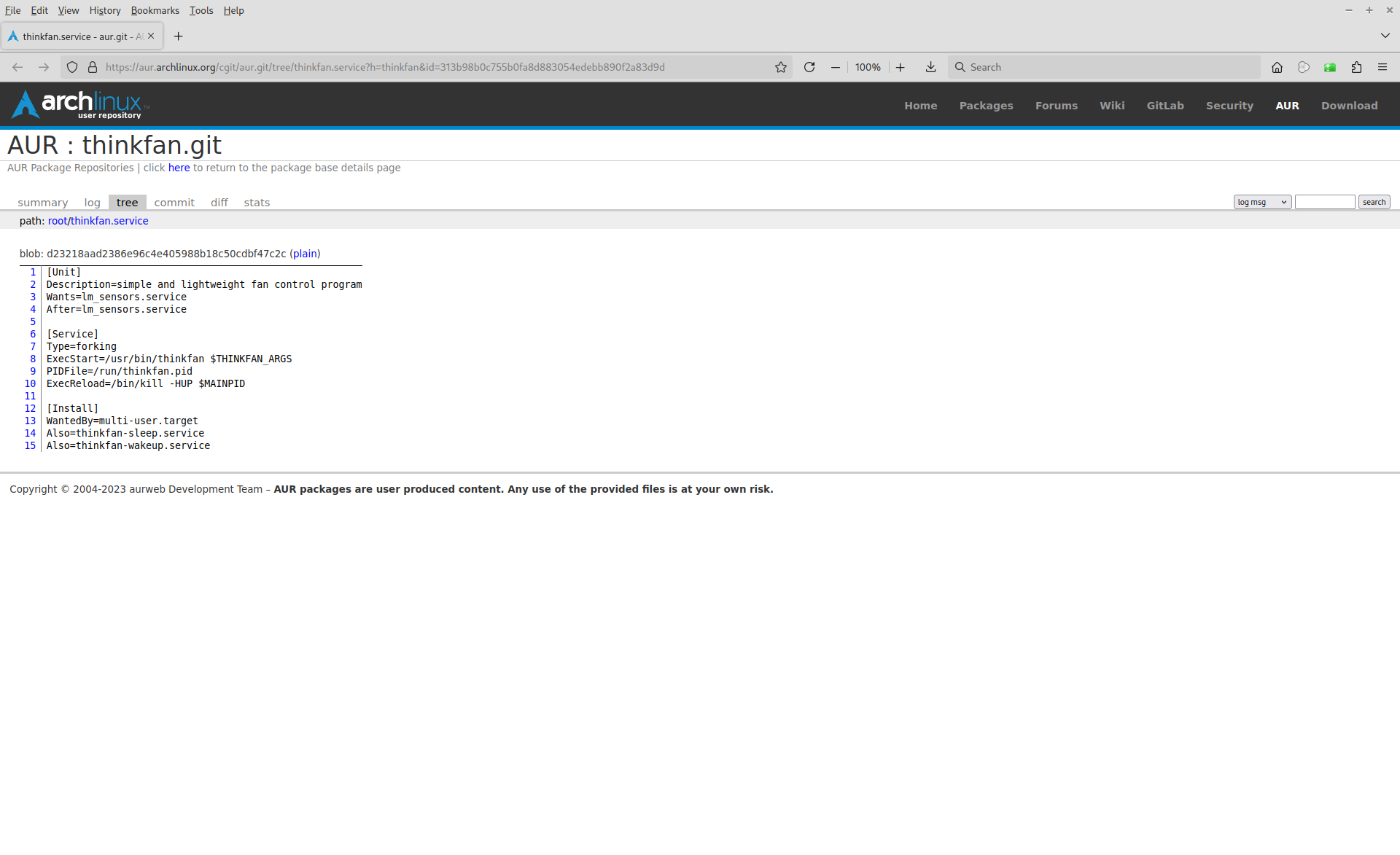

Set up a systemd service for it in /etc/systemd/system. The easiest way to do this if you haven’t previously written service files would be to find one in /usr/lib/systemd/system which starts something else at startup, then use it as a template.
There’s some helpful info about service files here.

It already includes one provided by the AUR packager. :wink:
In that case, perhaps one should still enable it… :point_down:
sudo systemctl enable --now thinkfan.service
:wink:

No, I linked to the service file from thinkfan. Nothing to do with thinkfan-git.

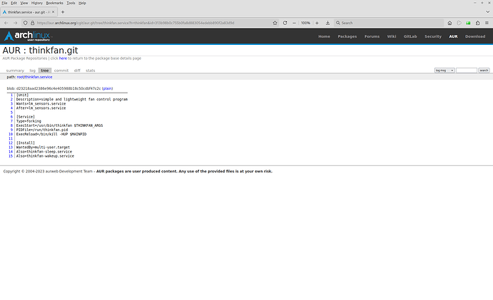

In your original post, when I click on the link I do get to a page with the heading
“AUR: Thinkfan.git” which was why I thought I had to use the .git version.

That’s because all AUR packages are git repos. :wink:

I guess you missed that these two words are a link:
