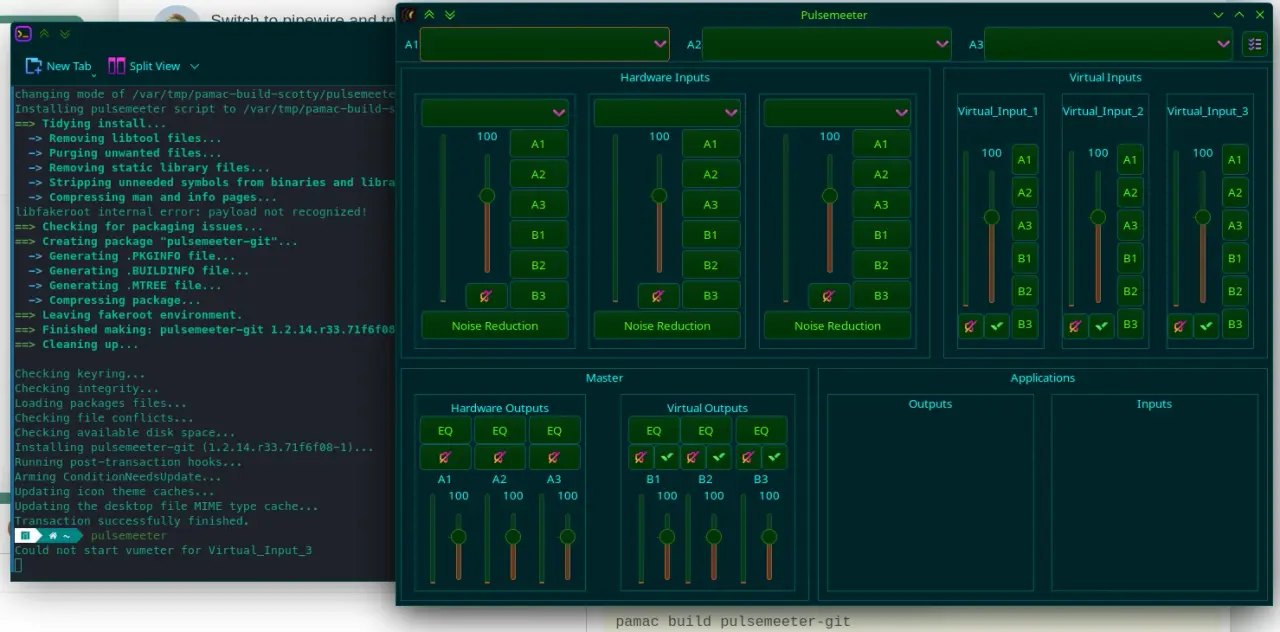

I just built it and it launched successfully:
Although, after I closed the GUI, pulsemeeter remained running in the background. I don’t do any audio stuff & don’t have a microphone, so I couldn’t test it. Anyway, give it a try - if it doesn’t work for you, then you can just remove it:
