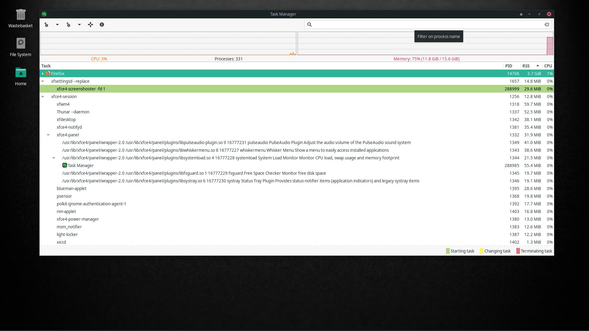

I keep having issue with memory on manjaro xfce where it will hit 100% and then firefox (and everything else) will crash and I often end up having to reboot. Here I am at almost 80% of memory used
The thing is, when I check task manager, Firefox is using around 4GB of ram, and then everything else is insignificant. So what’s using the other ~7GB? I’m running a plex media server under it’s own user but its idle and using only 40mb of ram. Other than that, I have no clue.

@mithrial there’s a top screenshot at the bottom of my post.
My problem seems to be that something uses 8gb of ram but that something is not listed anywhere.
