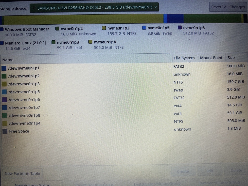

So what I did now is I plugged in the usb which has manjaro and I entered bios and booted into manjaro. So I did the installation process from the start again and when I reached the partition part I saw that the manjaro is actually indeed already installed and I thought it would be stupid to do it again here is the picture.

Is there a reason you have 8 partitions (which you cut the important information I guess in your picture)?

Delete existing manjaro partitions…including the 500mb no label Fat32 one.
Don’t make another efi partition
Use existing 100MB Fat32 partition…set mount point /boot/efi and add flag ‘boot’…don’t format it.
Make a root partition…mount point’ / '…flag ‘root’
Make a ‘linuxswap’ partition…flag ‘swap’
Now install Manjaro and reboot
So in simple words I have to delete all the partitions I have right now and then what do I have to do, I didn’t understand that part. I’m noob. If you have a video that I could follow or a guide or anything it would be great for me bro.
Delete the nvme0n1p5,p6,p7,p8 from live usb u already have
Select nvme0n1p1 and Click edit…set mount point /boot/efi and flag ‘boot’ & don’t select format option…select the ‘keep’ option(already selected)
Now select the large free space u have and click on create…Allocate 4100 MB space & set File System as ‘linuxswap’…click on ok or save or whatever.
Now select the large remaining space u have and click on Create…set mount point ’ / ’ …click ok or save or whatever.
U r now good to go
Install and reboot
