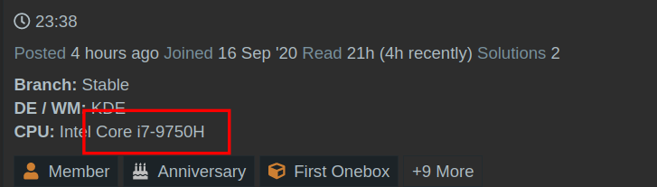

Yes, i have a core i5 12400, it’s 3 generation above yours.

I don’t believe i5-12400 is newer or should be more powerful than my i7-13700H:
this says that i5-12400 is from Q1 2022, while i7-13700H from Q1 2023. So one year newer. And I thought it should be i3<i5<i7<i9 at least when they are of a similar age.

You should update your profile then :
OK, pretty inaccurate.
