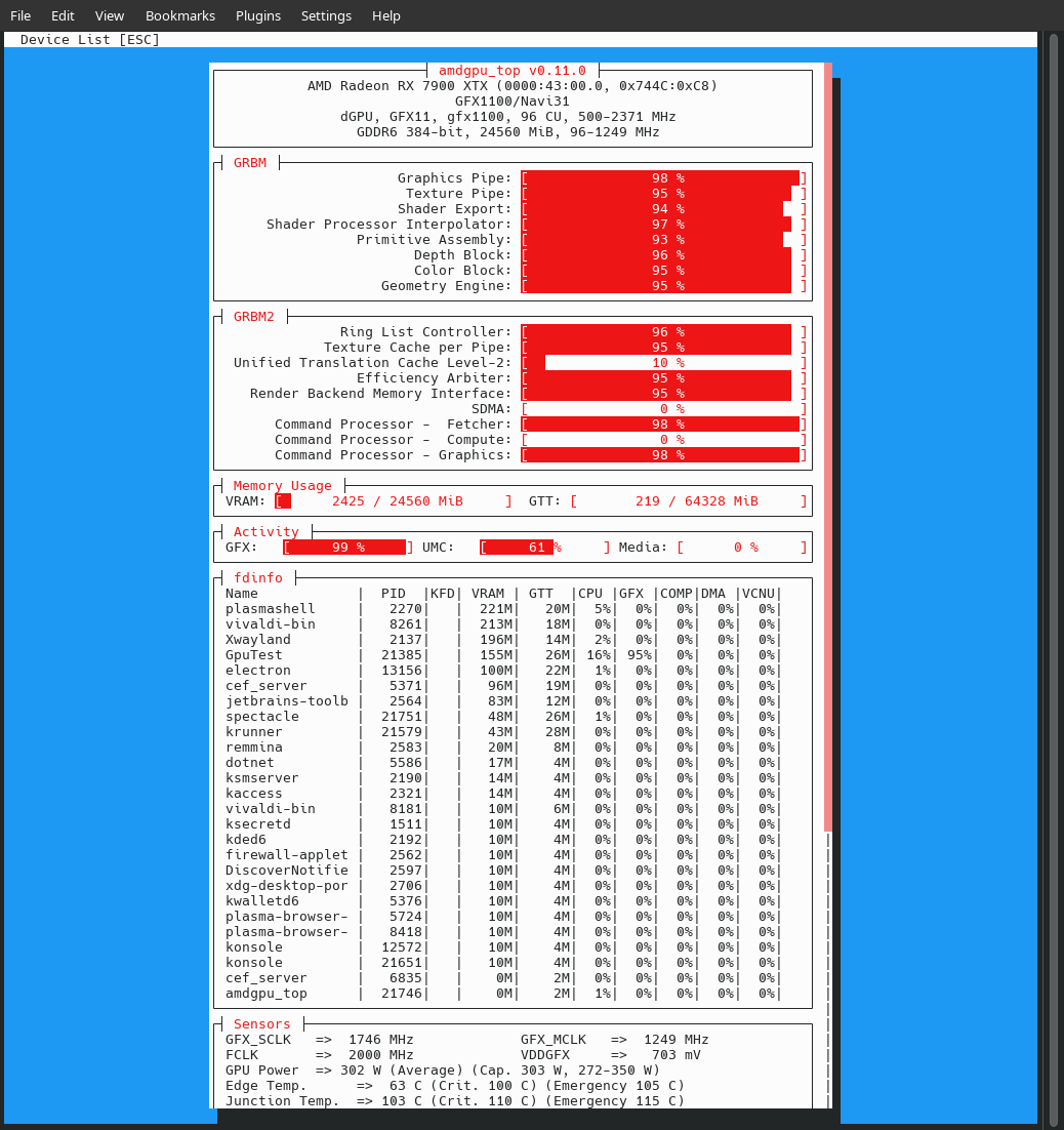

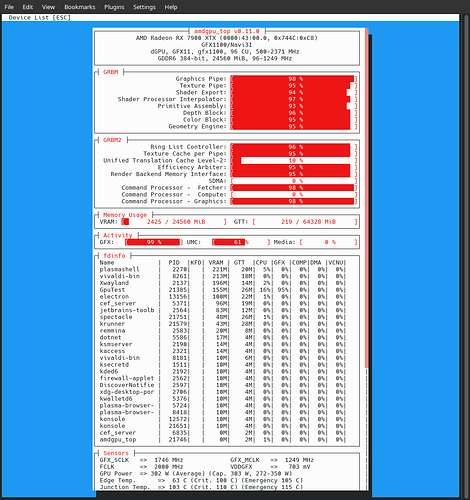

 $ inxi -CG
  Info: 12-core model: AMD Ryzen Threadripper PRO 5945WX s bits: 64
    type: MT MCP cache: L2: 6 MiB
  Speed (MHz): avg: 1790 min/max: 413/4101 cores: 1: 1790 2: 1790 3: 1790
    4: 1790 5: 1790 6: 1790 7: 1790 8: 1790 9: 1790 10: 1790 11: 1790 12: 1790
    13: 1790 14: 1790 15: 1790 16: 1790 17: 1790 18: 1790 19: 1790 20: 1790
    21: 1790 22: 1790 23: 1790 24: 1790
  Device-1: Advanced Micro Devices [AMD/ATI] Navi 31 [Radeon RX 7900 XT/7900
    XTX/7900 GRE/7900M] driver: amdgpu v: kernel
    compositor: kwin_wayland driver: X: loaded: modesetting unloaded: radeon
    dri: radeonsi gpu: amdgpu resolution: 5120x1440~120Hz
  API: EGL v: 1.5 drivers: kms_swrast,radeonsi,swrast
  API: OpenGL v: 4.6 compat-v: 4.5 vendor: amd mesa v: 25.3.1-arch1.2
    renderer: AMD Radeon RX 7900 XTX (radeonsi navi31 LLVM 21.1.6 DRM 3.64
    6.18.1-1-MANJARO)
  API: Vulkan v: 1.4.335 drivers: radv surfaces: N/A
    de: kscreen-console,kscreen-doctor gpu: amdgpu_top,corectrl wl: wayland-info
    x11: xdpyinfo, xprop, xrandr
That is the result I get
