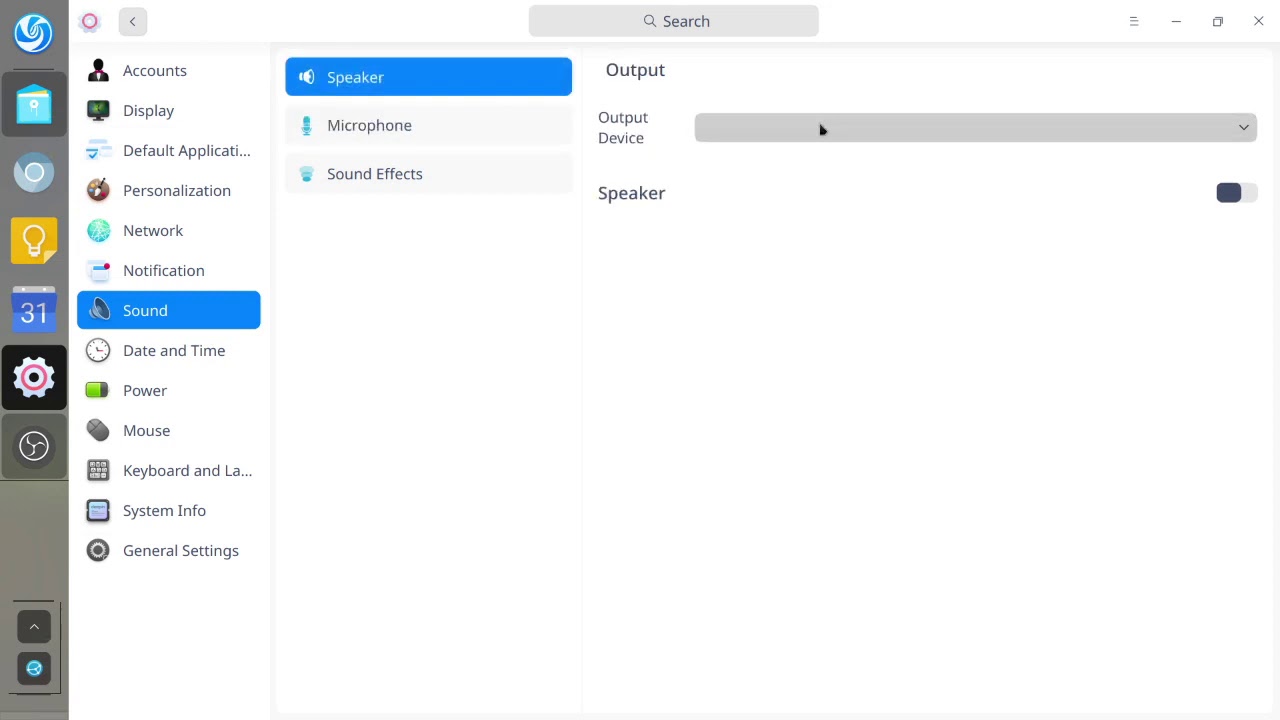

Just two days ago:
Is that Manjaro deepin current state? I have deepin deepin on a vm and everything works fairly sleek. Apart from AppStore obviously and outdated lutris form mid 2019.
Manjaro Deepin current state.
