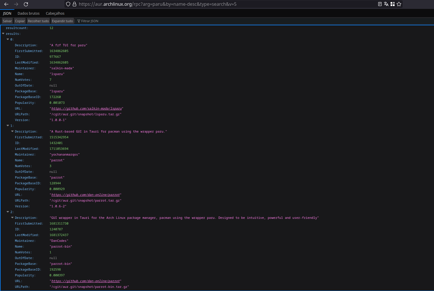

I can open the first 2 urls with a browser and a json is returned. If you cannot - then is a problem with your internet or dns. If you can acces with a browser, then the problem is in your helpers. The git urls has to be access with git normally, otherwise they will give 404.
I can see the Json:
so it’s not the dns.

No, not necessarily, web browsers nowadays have their own DNS servers set (Firefox uses Cloudflare for example, check the web browser settings).
Your system may use DNS server X but the web browser may use DNS server Z.
Check from terminal if you can ping aur.archlinux.org as this will use the system DNS server, which should be the same as the AUR helper.
But yeah sounds like a network issue on your end.

If the issue is on your ISP side, as said, a VPN may help (but as you successfully access the AUR from web browser, I would think it could be a simple system DNS issue, and your browser uses its own DNS server). Maybe you are banned from the AUR too, this happens for IP addresses abusing the service.

You could access the AUR with web browser so my theory might be valid.
