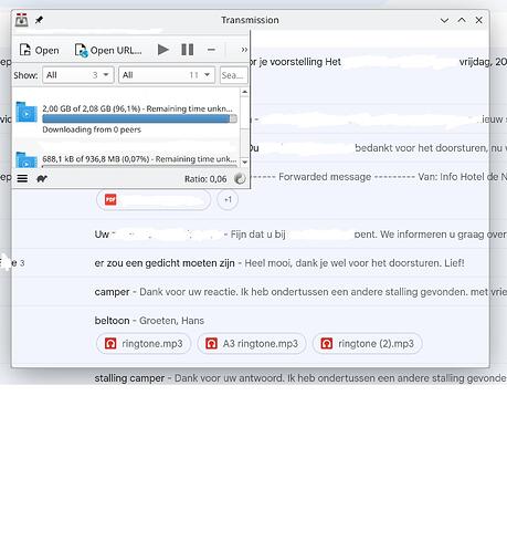

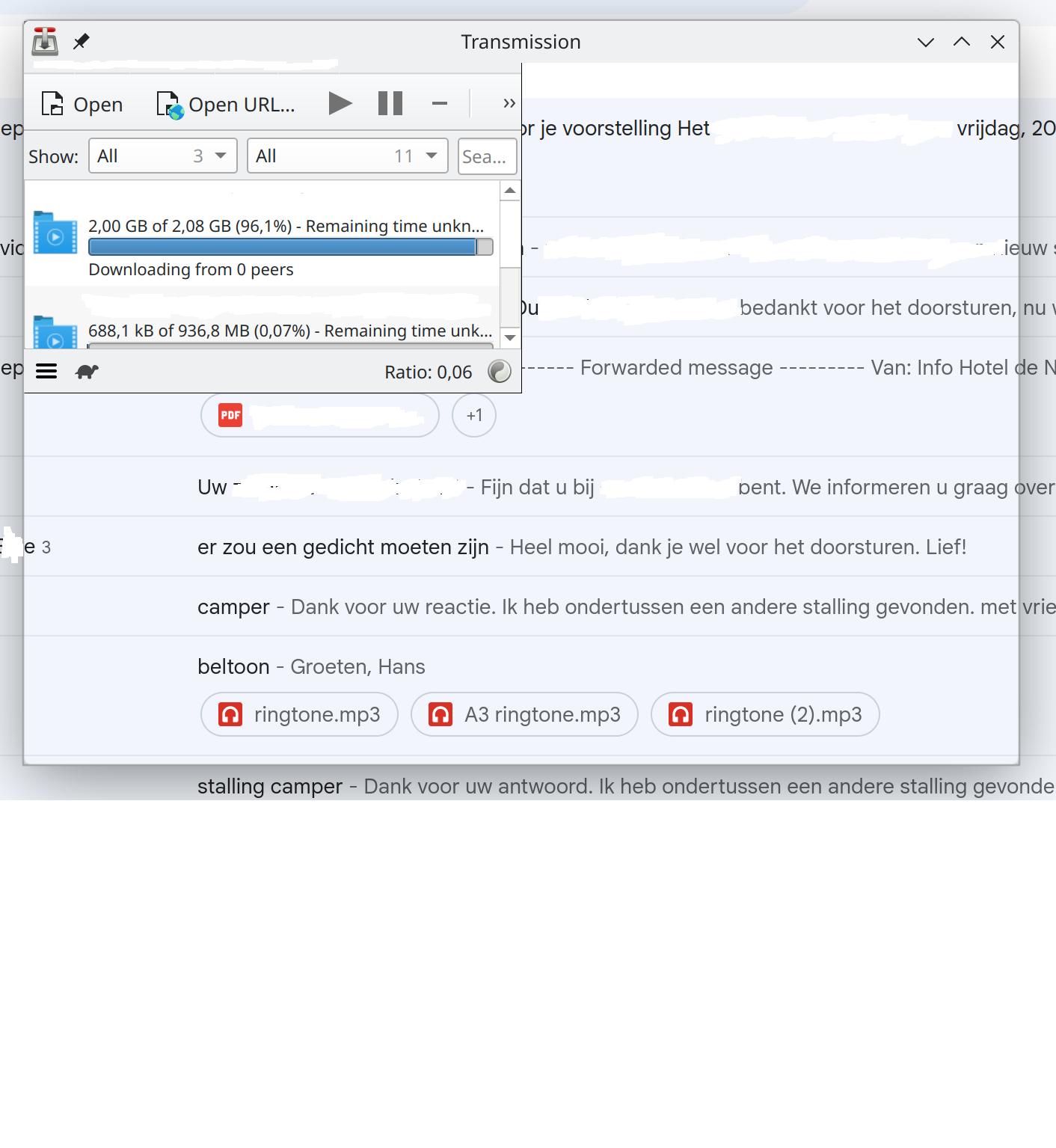

Yes, see below. What you see here, is a Transmission window (a Qt application) on top of a much larger Firefox window. In this window a small area (it is NOT a window) shows the actual content of the larger Transmission window. And the rest of this window is a copy of the covered underlying Firefox window or it is transparent(?).
As soon as I change the Transmission window size with a mouse drag, the small area completely fills the Transmission window. So then it is normal again.

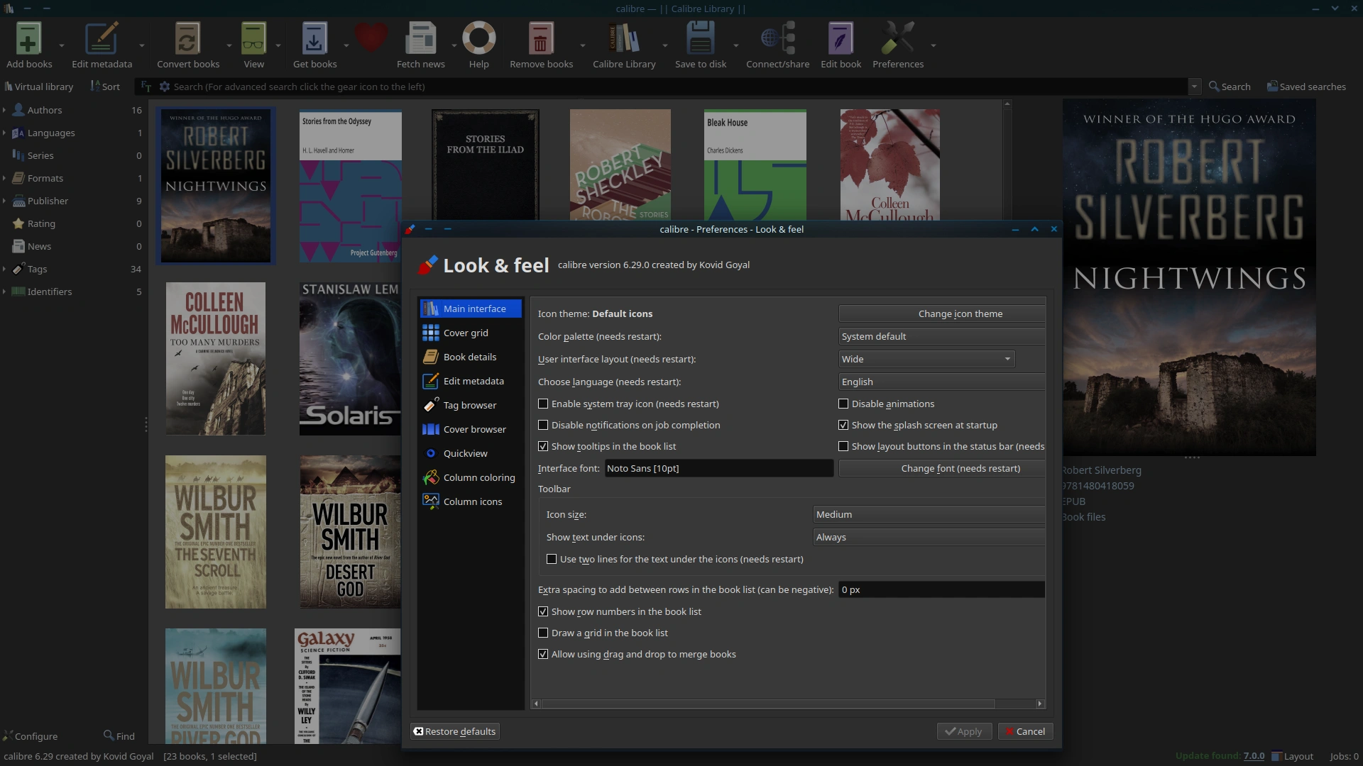

Calibre’s working fine on my new Ryzen mini-PC’s Plasma Wayland (screenshot below). I didn’t have any issues with it on my old Intel PC either, which was also running Wayland for well over a year before it died last month.
