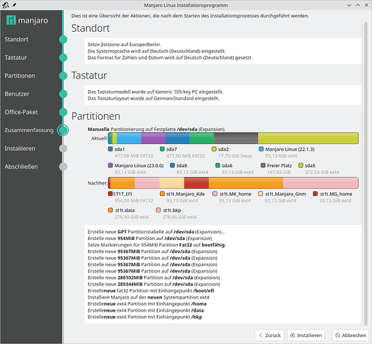

When I recalled that I have an external drive with old Manjaro installations, I tested whether the target system would boot from a usb port anyway - and it did!
So I plugged the (corrupt) Ventoy stick into the Target system (KDE running), downloaded the Manjaro-Gnome-iso directly to the Ventoy stick and tested whether the (before failing) Manjaro-KDE-iso would boot (and install) now.
… and it did!
(Obviously the before corrupt Manjaro-Gnome-iso - and nothing else - prevented booting with this stick.)
@ ‘Nachlese’ & 'soundofthunder": you don’t need to download/use gparted explicitly since the install offers the same functionality. Still, doing it per gparted before may’ve been more convenient.
