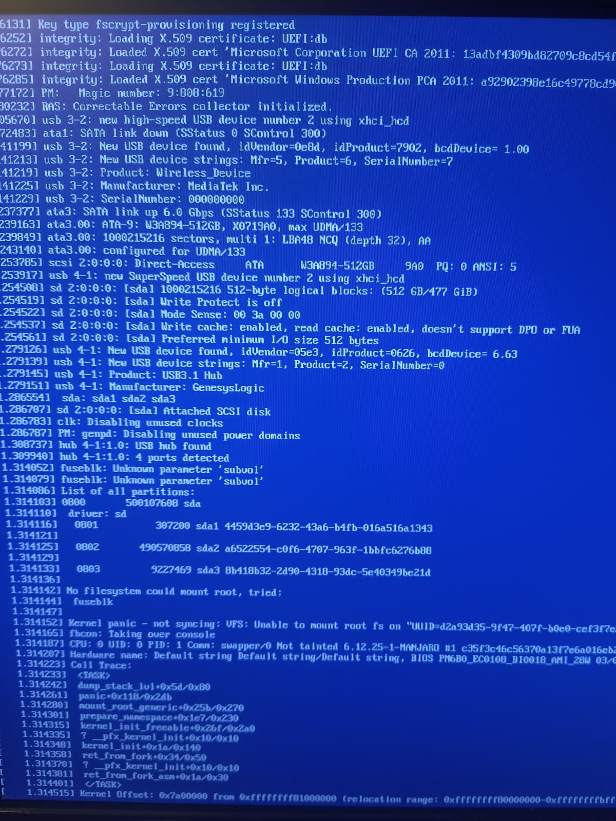

When I restarted, the machine started booting, but then went to a kernel panic. Since then, I have made multiple attempts to reboot, but every time I get the POST screen, and then immediately the kernel panic dump reappears (see photo).

The screenshot tells you that the system is not able to mount the root file system. I assume it was installed with BTRFS by default. Try to reinstall and use EXT4.
Thanks, but perhaps I wasn’t entirely clear. This is not a failure to mount. This is a failure to do anything beyond the POST screen. The screen shown in the photo appears immediately after the POST screen, without the boot process having started at all. And as far as I can tell, it is not a new kernel panic - it appears to be a frozen replica of the first kernel panic. I say that because there is no stream of error messages preceding this - just this static block of text, which appears instantly. And I haven’t gone through it line by line, but it appears to be identical each time.

No filesystem could mount root.
As was suggested, try starting your install from scratch and this time, choose EXT4 as your filesystem, instead of BTRFS. You will likely need to shutdown the machine fully before the next install rather than just rebooting.

Also, once again: the screen shown in the photo is, as far as I can tell, not a live series of errors, but a static screenful of the messages captured from the initial kernel panic, which is for some unknown reason being redisplayed over and over.
Could I be wrong? Of course, that’s always possible, but I’ve explained why I think this.
