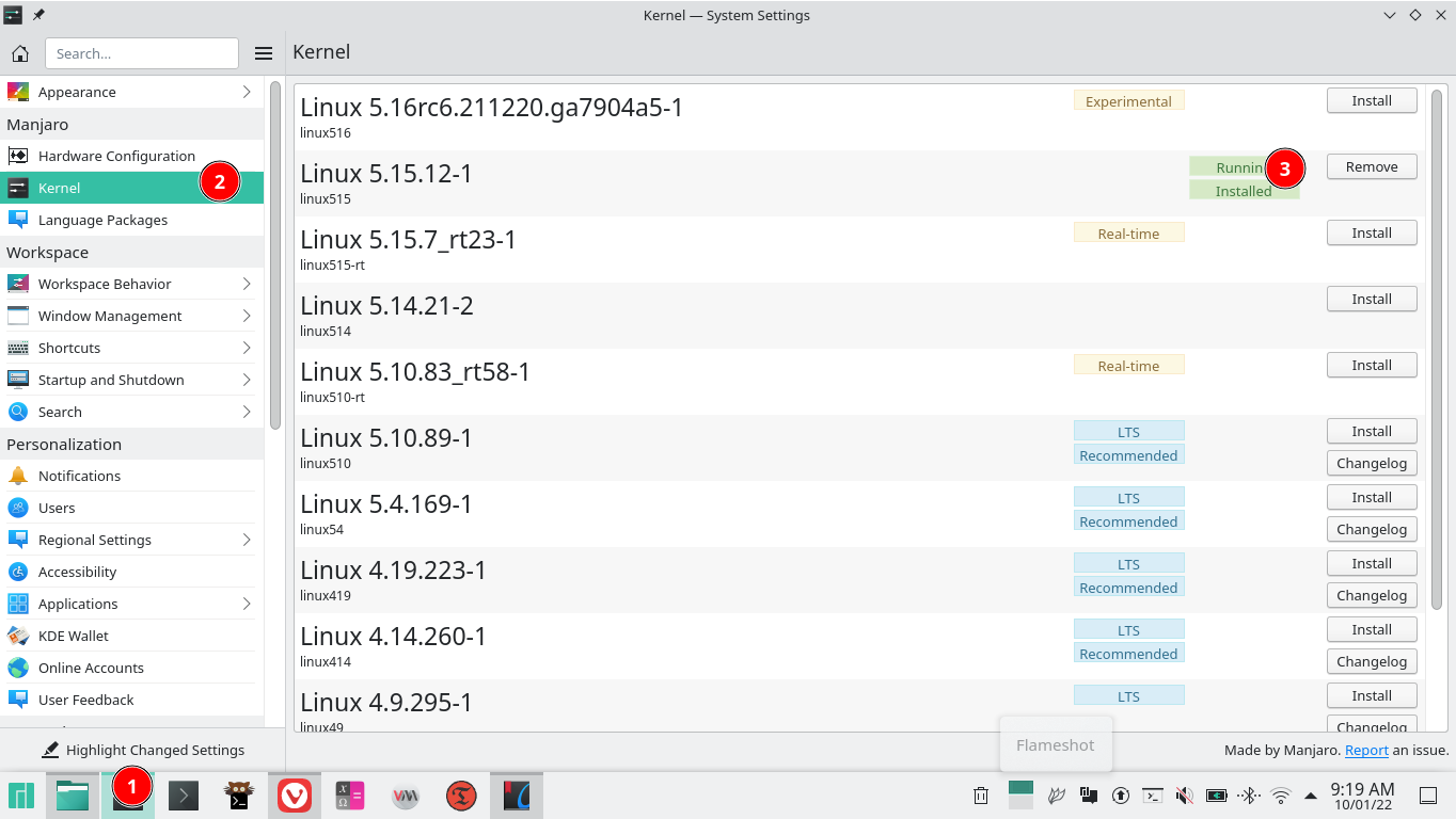

Kelltech:
5.4, 5.10, and 5.14
Since 5.4 and 5.10 have the issues maybe try 5.15 kernel…
Settings Manager → Kernels → Install linux515
