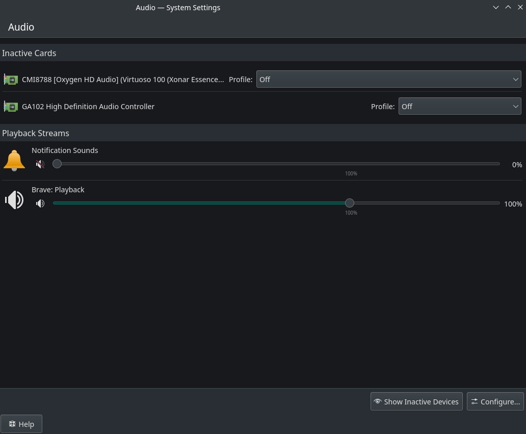

I’ve installed Manjaro a couple of days ago and everything worked fine.
Today there was a lot of updates, 67 I think, after being applied the system was still ok, but after it went to sleep I don’t have any sound output.
When I got into the audio configuration device only the profile for the graphic card hdmi output is visible.
I’m not sure about what is needed for information so looking at the other topics here are a few commands
