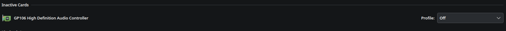

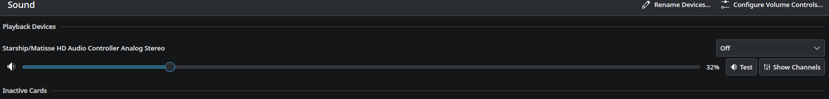

Some additional info.
This is a screenshot of the sound panel in KDE settings. The devices appears as disabled (Off)

I’m puzzled about this. Do you need the first audio device? Or can you check if the problem persists if you disable it?
No I don’t need the HDMI output but this wasn’t a problem until the latest update.
Besides, I have it already disabled in the KDE sound settings (just noticed it).
I want to figure out whether it is the culprit. The change could come from driver or kernel updates.
The first command gives no output.
The second shows some issue (I just put my system back to sleep and resume it in order to reproduce the problem)

If you click on the dropdown menu showing Off, it should be possible to change the card profile to use an active profile - for example Analog Stereo Output - if such profiles are available
Please post more information to show available profiles
pactl list cards
The only other available profile right now is Pro Audio (which never worked in the first place). If I restart the pipewire, pipewirepules and wireplumber there will be more profiles available.

To me looks like the ALC1220 is completely disabled (or not detected).

pactl list cards data shows information for HDA NVidia card only and card is disabled
pactl list cards
Card #591
               alsa.card = "0"
               alsa.card_name = "HDA NVidia"
               alsa.id = "NVidia"
Active Profile: off
But there is no data for onboard audio device alsa_card.pci-0000_09_00.4 to compare with pactl info and pactl list sinks data in previous posts
               alsa.card = "1"
               alsa.card_name = "HD-Audio Generic"
               alsa.id = "Generic"
I suggest:
  1. Reboot system to get both devices detected and working normally
  2. Check both devices are detected as playback devices in ALSA: - aplay -l
  3. Get card data when audio playback is working: pactl list cards
  4. Suspend and resume system
  5. If audio playback is not working after resume, get card data pactl list cards
