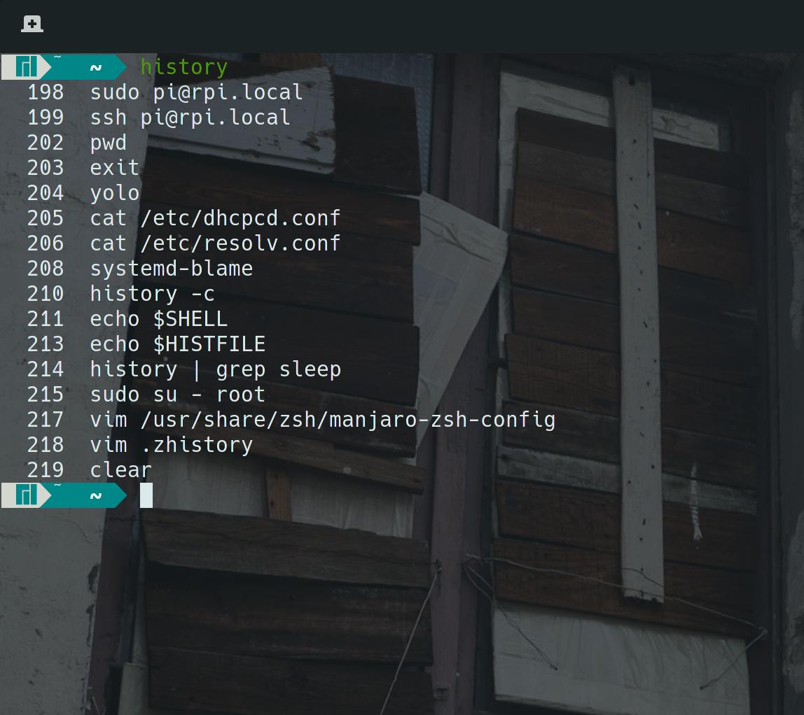

I noticed that my .zhistory file doesn’t have the older commands I gave. It is just a 4.1KB file usually and has around 200lines after noticing the same repeating over some time. This really bugs me. As I always mess up trying to do somthing, this was a reliable source for me to trace my steps.The bashhistory was reliable in this manner( when I was on Ubuntu.)
I use a gnome-terminal on manjaro gnome DE.
My zshrc is at the default configuration.
Is there any way I can prevent this from happening?

Any update to this? I’m also seeing a ‘short’ history under zsh and Gnome.
It’s already there if you have your system updated, with latest manjaro-zsh-config
. My .zhistory is over +2000 entries already, up to the potential 10K new limit.
This is my current version:
Is there something I need to enable to have the updated entrees kick-in?
I don’t think so. It should already be sourced from your /usr/share/zsh/manjaro-zsh-config
, where if you look inside, you should see the new values
HISTSIZE=10000
SAVEHIST=10000
If you still wanna be sure, you can source them manually in your .zshrc
, or maybe use other different values.
That’s because in zsh, unlike in bash, the default history
command it’s effectively like history -15
or so, to show last 15 entries.
history 1
Try that one instead. That’s like show all entries since first one.
