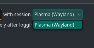

  • Session type
    echo $XDG_SESSION_TYPE wayland

  • Last time I checked about a month ago, I remember my session being of type X, but it is now Wayland.
  • Opened a cross-post on KDE Discuss
    • They told me that I might have deleted the X11 session packages, but I do not remember doing anything like that.
      • I still have some X binaries installed
        which xmodmap startx
        /usr/bin/xmodmap
        /usr/bin/startx
plasma-x11-session and kwin-x11 were not installed. I reinstalled them and rebooted my system.
I did not manually delete them, but I noticed quite a few things went out of wack one or two KDE releases ago… I just fixed the minor things without thinking too much about it until I realized that my keymaps were also not right.

kwin-x11 was split into a separate package and as such it was never installed. I presume plasma-x11-session is also a new package and thus wasn’t installed either.
$ paclog | grep kwin-x11
[2025-08-04T20:13:20+0100] [ALPM-SCRIPTLET] The KWin X window manager has been split to a separate kwin-x11 package.
However that shouldn’t matter, and this affects more than just xmodmap - there seems to be a bug which is fixed/overridden by something in one of those packages. :man_shrugging:
