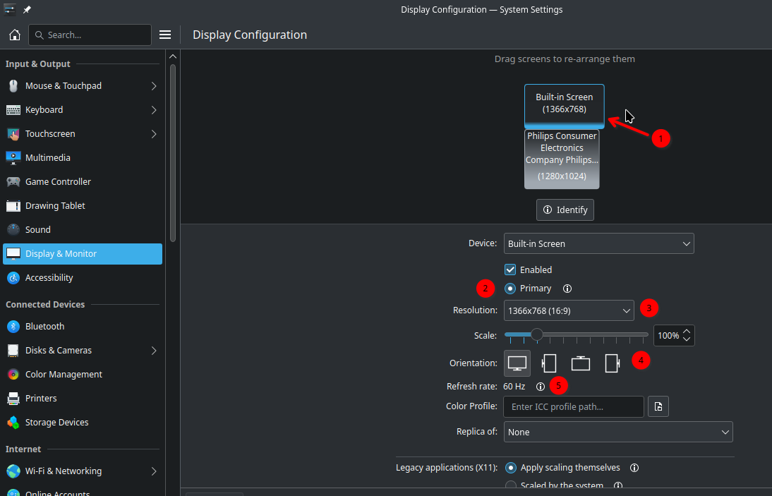

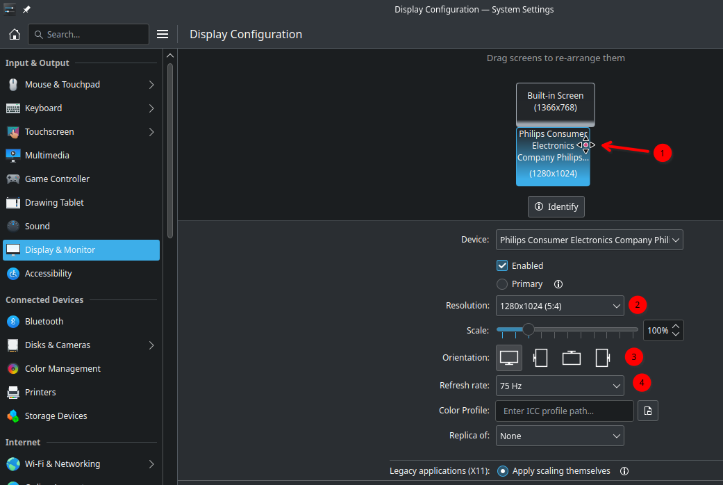

You don’t need any command line to setup your monitors on Wayland, simply use Plasma GUI to do it.
First grab your monitor by mouse in Plasma settings to position it under your laptop screen, and set its resolution, orientation and refresh rate.
Then select your built-in screen and set it to primary, and also set its resolution, orientation and refresh rate.
