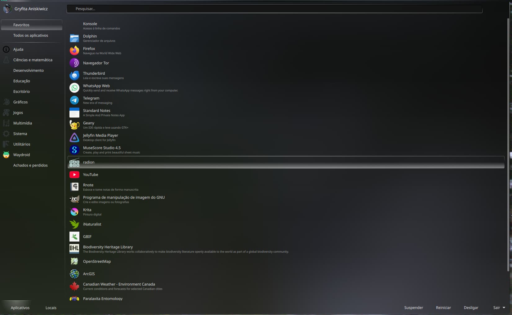

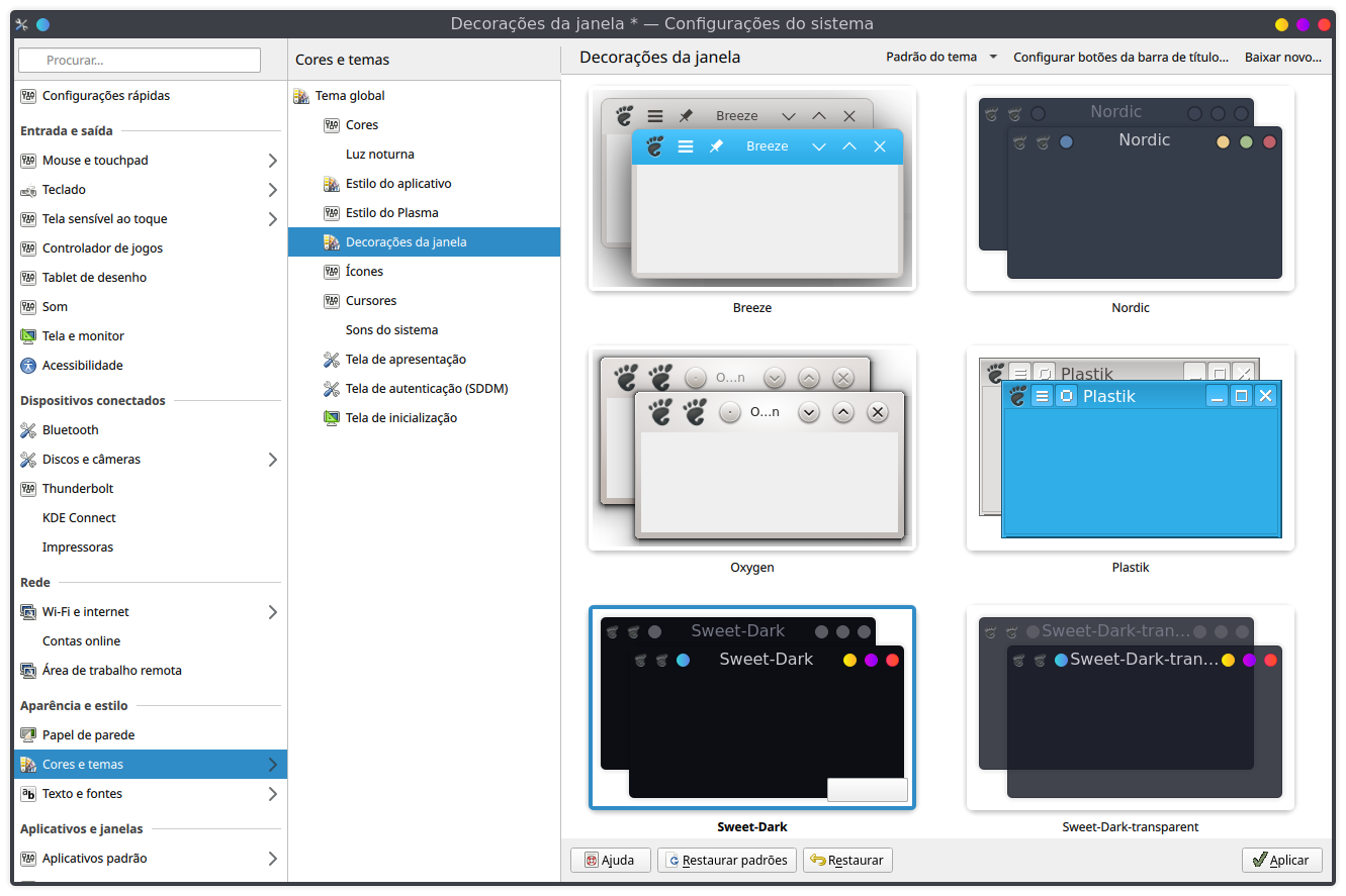

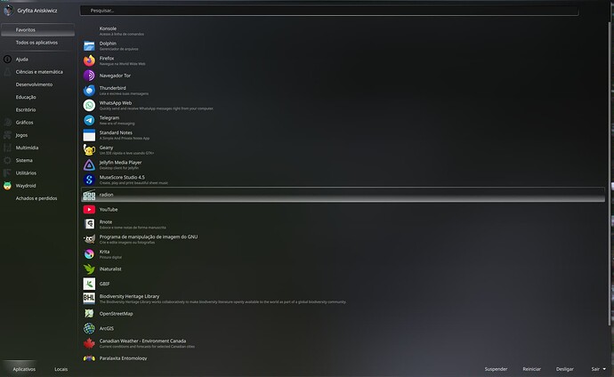

After a system update a little while ago, I noticed that most of the UI elements are incorrect. Many icons are missing, incorrect, or showing improper resolutions. The text colour in many elements such as the panels and menus are not adjusting to theme settings (staying black and being impossible to read), as well as KDE application theming.
In my system, some GNOME UI elements are being displayed, such as icons, despite not having GNOME installed. Note the generic icons used for the sidebar in the system settings application, and how window titles in the panel are the correct colour, but other elements like the system monitor widgets are not. Despite having all my theme settings being set to Breath Dark, much of the UI does not respect this.
Is this due to mismatched config files? A corrupted system perhaps?
Any advice is greatly appreciated

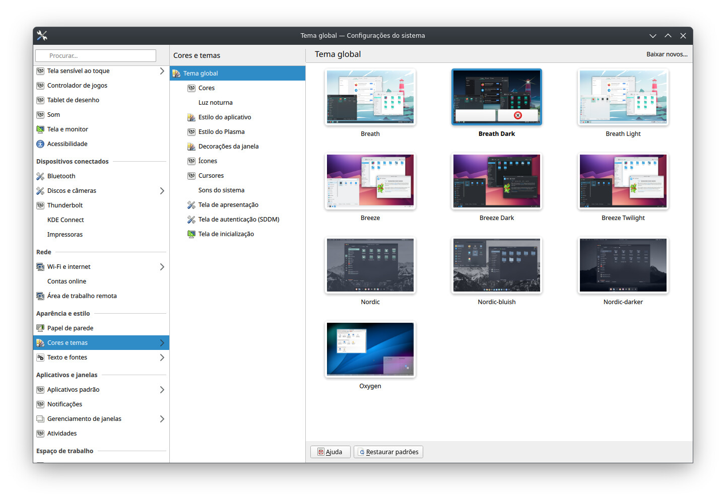

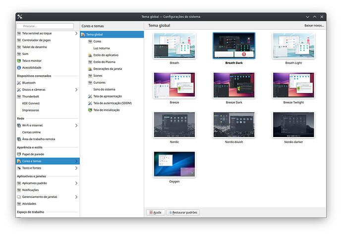

My guess is that you have inadvertantly deleted part(s) of the Breath global theme; perhaps as a result of other themes you have installed and removed.
  1. Switch to the Breeze Dark theme and see if the issue persists.
  2. Create a new user acount (for testing) and see if the issue occurs there, when using Dark Breath.
Let us know the results.
