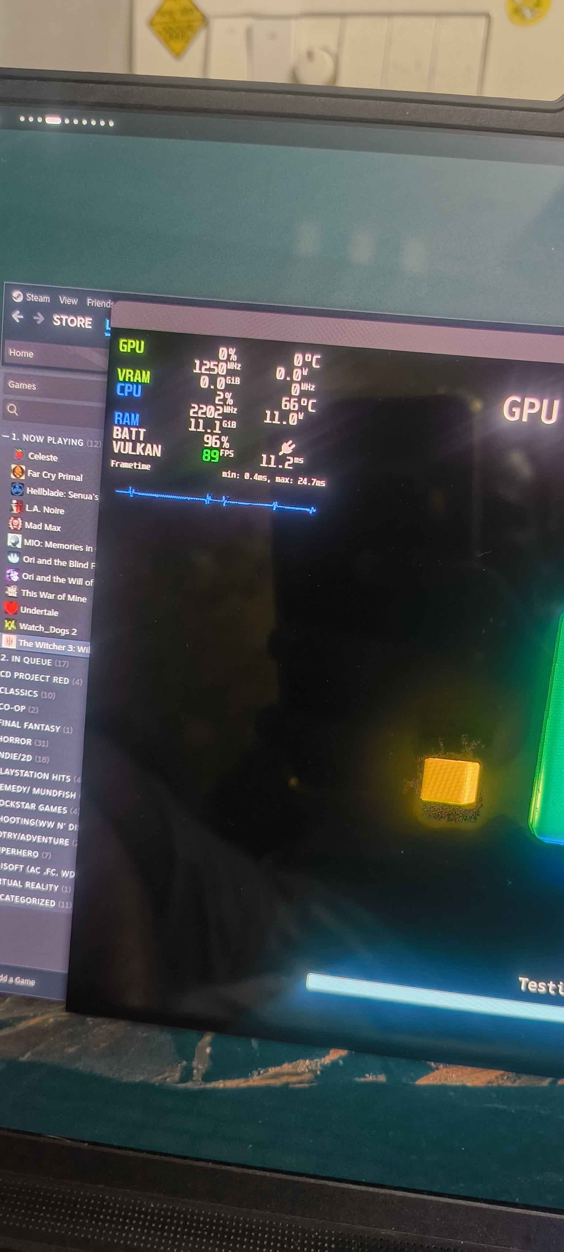

So witcher 3 had some problems, the game is running on igpu and I had to use this command , __NV_PRIME_RENDER_OFFLOAD=1 __GLX_VENDOR_LIBRARY_NAME=nvidia VK_DRIVER_FILES=/usr/share/vulkan/icd.d/nvidia_icd.json %command%, so now I can tell the game is running on dgpu rather than igpu, but now I can’t use dlss settings or framegen, xess framegen is working but the output is horrible, so how does the settings work and how do I run mango hud along with that nv prime render code? And mango hud is only showing gpu clock speed and not temp or power intake, i installed mangohud through pacman, not flatpak

Yeah cool man, soo… What about the absence of gpu temp and watt reading on mango hud? There is a pic in the query
Did you enable them in the mangohud config file?
Also there is usually a trail from others that have gone before you here: https://www.protondb.com/app/292030
Mangohud is probably showing the stats of the unused GPU. You have to switch to the other GPU in the mangohud config file.
Maybe you should use a GUI tool like GOverlay for that task!?
You stats are also absent in steam overlay, so I thought it’s an nvidia issue
