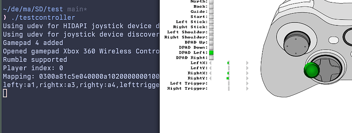

Update on this one. I build SDL locally and ran the testcontroller tool. That works, so I guess it must be Steam related.

True, you are right, it wasn’t a solution and I didn’t solve the issue, as I didn’t get it working, I just realized it does not seamed to be related to SDL.
I did build 3.2.28 and ran test/testcontroller. There I see the mappings are correct, so at least related to my topic title, this does not seam to be an SDL issue. I even see the correct mappings now when I test it within Steam, but in any game they are still wrong. So my next guess is Proton.
