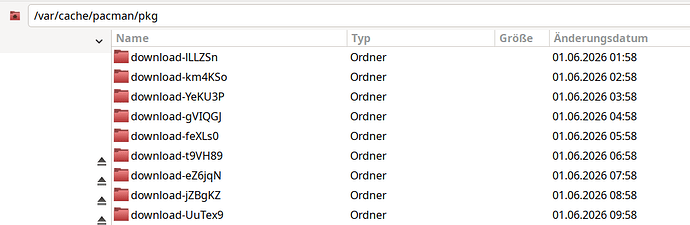

What is going on here every hour?
As to be seen in sreenshot, something creates an empty folder every hour.
Pamac updates every 6 hours !
Did not look into journalctl at the moment … will do that later!

.. but that explains nothing for me !
Any ideas ?
