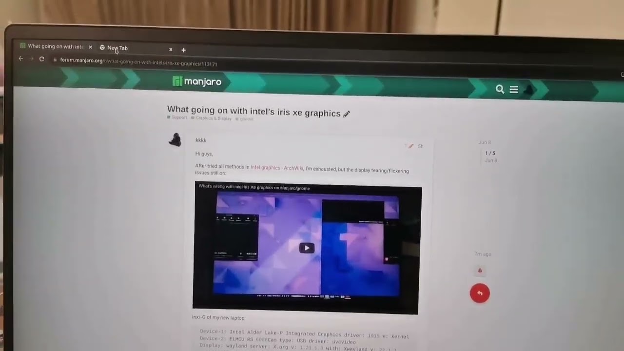

Hi guys,
After tried all methods in Intel graphics - ArchWiki, I’m exhausted, but the display tearing/flickering issues still on:

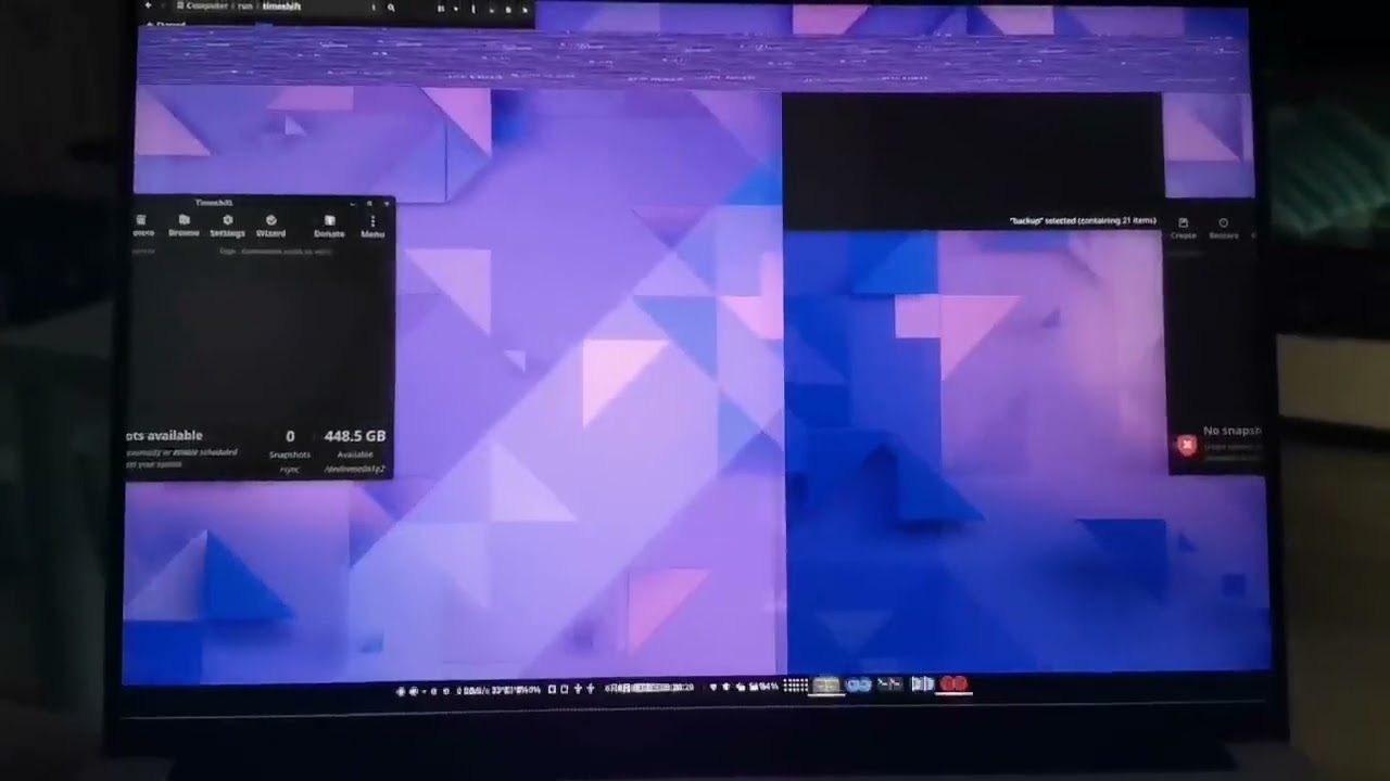

More details: The flickering problem not exists all the time, it comes up when I move the cursor to some positions on screen, see this:
Same issue under X11, or only under Wayland?
Wayland. haven’t tested on x11.
