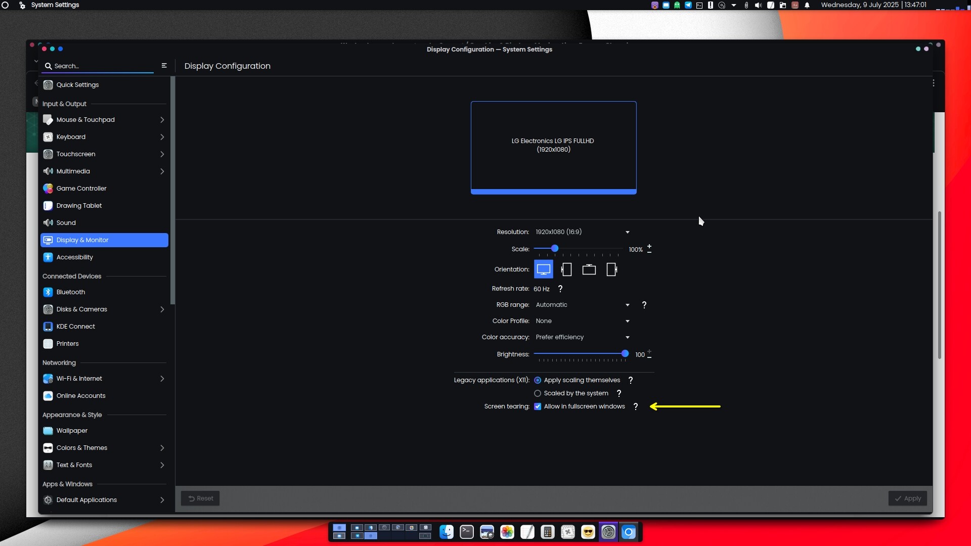

So if i disable allow tearing for full screen it won’t do a thing.
I can force Vsync for some games with Mangohud or Gamescope, the thing is that for Cyberpunk those don’t work. Cyberpunks own Vsync causes tearing to happen on upper part of the screen.
I just want to find a way to get tear free experience on that game. Was thinking that Waylands own vsync would have helped, but it seems that it’s disabled for full screen apps and i didn’t find any way to turn it back on.

Again, I’m no expert in this field, but perhaps the above can help you on your way of debugging this. In KDE Plasma’s System Settings, there’s this setting, for instance… :point_down:
I tried xorg.conf tearfree if it would be because it’s running X11, but that did not help. All other games ive tested get the vsync from Mangohud + Goverlay settings to force vsync on for the games.
I have ticked that box off, but it doesn’t seem to be doing anything. For example if i set vsync off from Goverlay it gets turned off for all games, but Cyberpunk. I think that the KDE settings do not do anything really to set or set off the tearing.
I think it’s just allowed tearing by default and no way to change that behaviour.
I think that when it’s set to allow screen tearing and graphics drivers don’t have possibility to change that it might mean that it does exactly that what means that it does nothing.
Sadly it was set to allow screen tearing by default cause before it wasn’t and was working with all my Xwayland running games as well to not allow tearing.
