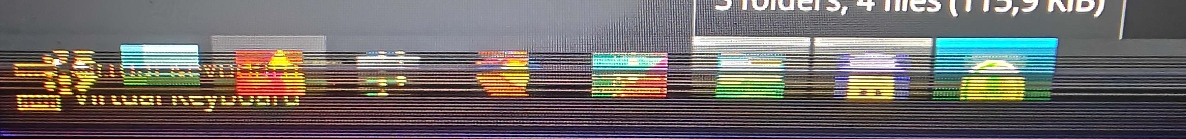

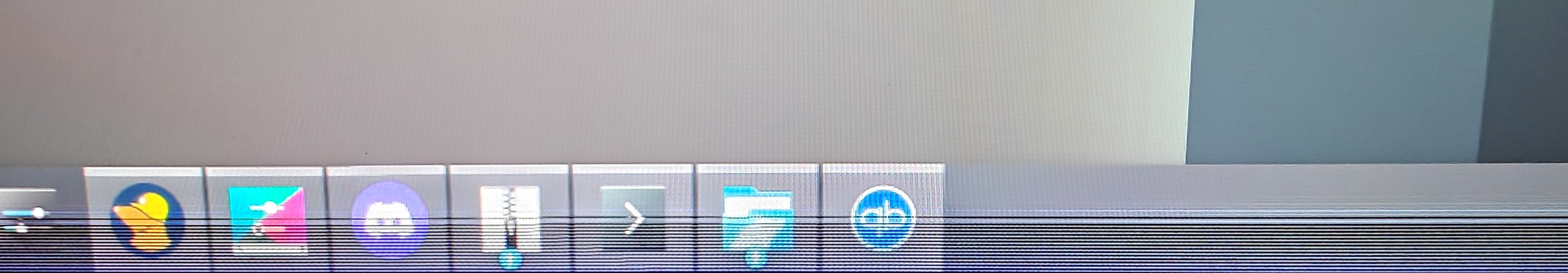

Hello,
I’m experiencing recurring display artifacts and kernel spam on my Manjaro system. I’d like to report the issue and provide as much information as possible. This issue has been present for quite some time, but in light of the last update and the invitation in the related stable update post to report things that aren’t in order, I thought it’s the good time to report it.
Problem description
  • On my primary monitor (4K, landscape, scaling at 140%), I sometimes see horizontal lines/artefacts at the bottom of the screen.
  • These lines do not disappear after a reboot once they appear.
  • They are not always present, but when they are, they persist.
  • I’m running Wayland (Plasma/KWin) and would like to stay on Wayland, though I can test X11 if requested.
  • At some point during the information gathering for this post, the artifacts disappeared without obvious cause (possibly after running diagnostic commands, though I cannot confirm a link).

Try to switch to testing branch to see if kwin 6.4.5 is fixing the issue. Else you can also try 6.12 LTS kernel.
@Wollie - Sorry, I read too fast. The primary monitor is connected through a display port cable (version 1.4 DSC, says the screen) ; the secondary monitor is connected through an HDMI cable.
@philm - I’ll try the testing branch, and I’ll come back to you here to give feedback.
I’m now on the testing branch, and I went for the latest (experimental) kernel, and it seems that the message
kernel: amdgpu 0000:0d:00.0: [drm] Mode Validation Warning: Validation OK failed validation.
has disapeared.
For the display artefacts, for now they aren’t there, but since they apeared randomly, I’ll have to test it out for a few days to see if they come back - I’ll report on it.

The artifacts are there again.
It happens when the computer is left to itself for some time and the screens get turned off. Once the computer is solicited again, the display artifacts appear.
This time, strangely, I can read ‘virtual keyboard’ in the artifacts, which may be a clue on how it happens.
Below, the part of the output of journalctl --user -b0 | grep -E "kwin|plasmashell" that corresponds to when the computer was solicited again.

Perhaps interestingly, the artifacts are not stable - in the time I took to gather information and to write this, it has evolved to this :
For all that may be interested, I think I finally figured the display artifacts. They are probably hardware specific to my LG 27GN950 display. When displaying through Display Port version 1.4 it allows 120Hz refresh rate. Supposedly, it supports 144hz if Display Port 1.4 (DSC) is selected in the OSD.
Initially, this problem wasn’t there, but it is now. The hardware can’t handle that, its performance degrades over time, which is good to know.
I knew there was a microcode update for that display that allowed to have a 155hz refresh rate, but to apply it, the ONLY way is to have a Windows OS to use a LG program that manages that update.
Last week, since I had this artifact problem anyway, I finally decided to install Windows JUST FOR THAT - Windows stupidly crushed my EFI partition and wrecked my GRUB, as usual - and I managed to get it done.
I selected that new option in the OSD to have it go to 155Hz, and, lo and behold, the artifacts were way, way worse. At this point, the only refresh rate it really does correctly it seems is 120Hz, with Display Port 1.4 - no DSC. I checked with another GPU, and it really is this screen. bad luck for me!
TL;DR - it is the monitor’s hardware and/or microcode that is to blame.
