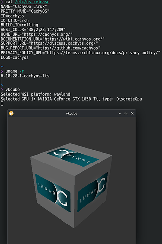

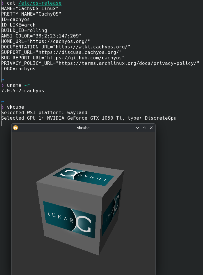

Alright, so to address the issue of the non-functioning driver, I first switched to the Unstable branch of Manjaro to get the packages as close to mainline Arch as possible.
As expected however, this did not address the issue, as vkcube continued to fail to run.
Then, I wiped out my Manjaro installation, installed CachyOS in its place, and without having to do anything else…
…the driver is fully functional.
On both the LTS kernel…
…and even on the stable kernel.
As I already strongly suspected and hinted at, it appears that the Nvidia 580 driver is incorrectly packaged/configured on Manjaro, which is why Vulkan functionality was lost completely after the upgrade from 575.
A significant bug, which would’ve been reported and fixed months ago by the manufacturer if it had been caused by the driver itself.
Rather, using the same kernel and driver version on CachyOS as I did on Manjaro, there are no issues on CachyOS.
