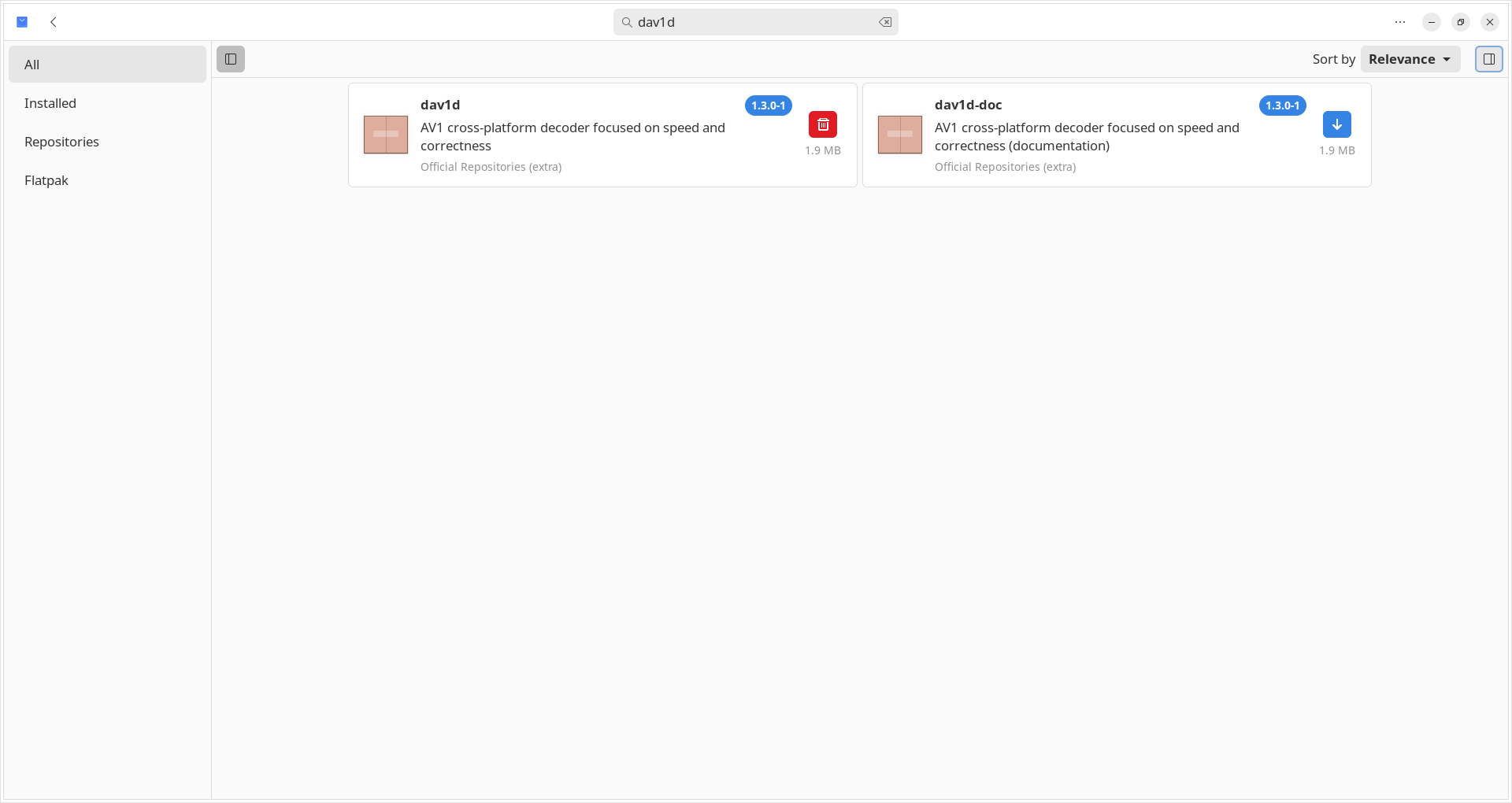

It seems that dav1d is already installed from before…
