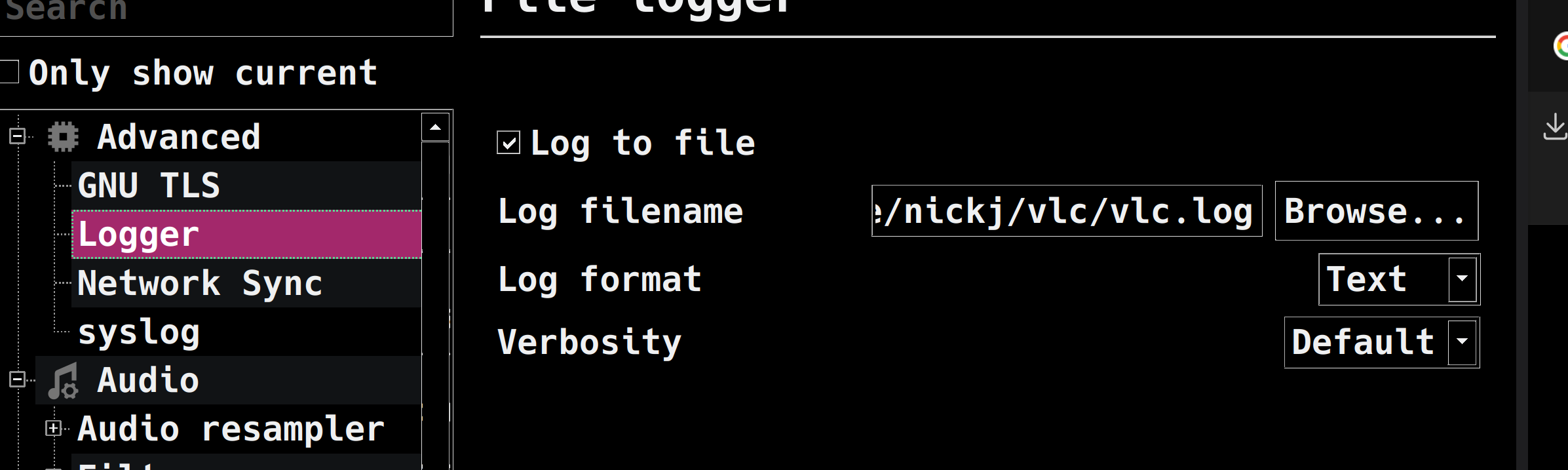

Tools → Preferences → way down at the bottom: select the “all” checkbox
top left then is: Advanced - and below that: Logger
check: log to file - give it a name and location or choose an already existing file …
Starting vlc from a terminal rather than via the menu could also give some helpful output in that terminal - I don’t know.
I am doing your ins., I see no .log file after the crash.
It looks like you first need to create the file - and then select it and save …
for (your) example:
touch ~/vlc/vlc.log
select this now existing file as your log file from within the vlc settings - and save
… this is the first time I have used the program and this procedure worked for me - there is something in that log file after I started the program and played a clip I had locally

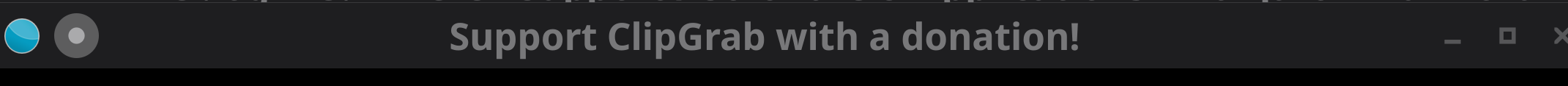

I have clipgrab already, I know how to use .appimage files. I do not see where to paste the URL when I open it. Just that and the rest of the window has nothing. The how to use vid. it is white & white is to bright to see the details for me.
Here is the link to a screenshot of what clipgrab looks to me:
Bildschirmfoto - Imgur
You copy the URL from the browser and paste it into the input field below the blue “Please enter the link to the video you want …”
Wait a few seconds, then the “grab this clip” button to the right becomes active - and click it to initiate the download.
