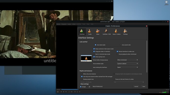

my vlc and kmplayer are not palying videos in a single window. there’s one layer for the video and another is the default application window with all the controls…
any help regarding this would be great…
thanks in advance
this is for vlc, go to tools > preferences > and check this option :point_down:
Screenshot_20220104_192721
restart vlc
thanks very much… i looked at the option yesterday thought about turning it but didnt … :sweat_smile:
btw km player also has the same issue
its still happening for some videos …
try setting auto-raising the interface from never to video
its still the same

My vlc has “Integrate video in interface” checked by default already, so that didn’t help when I encountered this behavior. What did fix it for me was setting Preferences->Video->Output to “X11 video output (XCB)”. I am still running Xorg and not Wayland yet, so I haven’t tested this with Wayland, but it might be worth trying.
