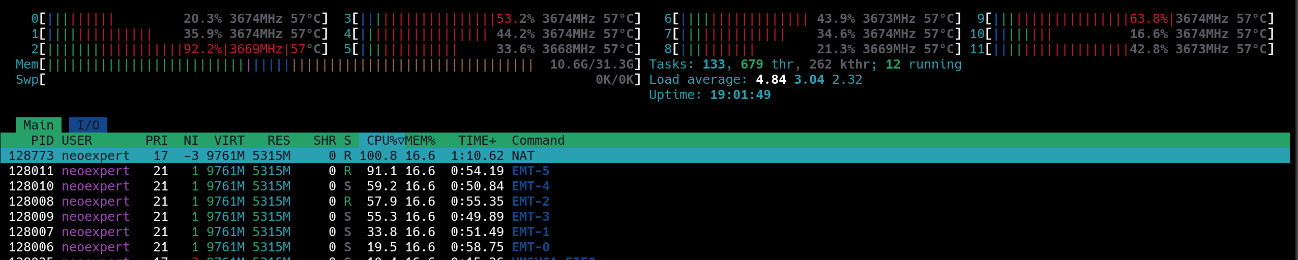

I had the same problem after an update. I fixed it by changing my networking to a Bridged connection instead of the NAT that I was using before the update.
The “in” column shows about 1000 interrupts. But after VM launch it gets to about 120 k. And the VM lags a bit, but sometimes it just freezes completely without resurrection. I’ll post the output of the commands later, when I am on computer again. I thought too that it could be because of Virtual Box - NAT because htop showed the NAT thread of Virtual Box used 100 percent of CPU. But disabling the network lead still to the same amount of interrupts.

High CPU usage with VirtualBox 7.2.4-1 https://bbs.archlinux.org/

It seems like this could be the same problem to me?

EDIT: no the issue is still present, but only when I switch network mode to NAT:
I think it is the same issue that was reported here:
Yes, it certainly seems to be. That being the case, we can only wait until the bug has been squashed upstream; and then of course, for the respective fixed version to filter through Arch Linux and Manjaro branches.
I note that Virtualbox 7.2.4-1 is currently in all Manjaro branches. It’s difficult to speculate as to how long the process might take.
