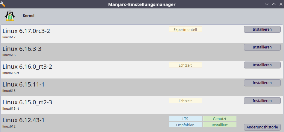

But there is a difference 6.12.41 ./. 6.12.43 shown in Manjaro-Settings-Manager:
What can I do?
Your currently running kernel is:
6.12.41-1-MANJARO
The picture shows 6.12.43-1 however
and that is what is expected to actually be there by the host modules package.
At the moment I have no idea where that discrepancy comes from.
The pre-compiled host modules will not work if the running kernel does not match.
I’d always opt to use the DKMS version …

I guess, it’s caused by the actual UPdate: I installed virtualbox (having version 7.2) and shortly after that, my computer announced today’s update.
$ pamac checkupdates | grep 43
linux612                    6.12.41-1                   -> 6.12.43-1                   core
What do you think?
I just ran an update - among it was linux6.12.43-1
Did you actually reboot after that update?
Do the update and reboot - then the versions will match.

The kernel GUI will show the new version as installed and running -
even though it is just installed, but not yet running.
Blame pamac or whatever … :wink:
reboot and then it will actually tell the truth :grimacing:
