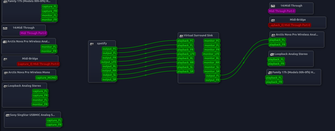

The virtual sink takes the normal surround sound inputs from an application and uses JConvolver to mix them down into a stereo mix. I will attach an image of the audio piping seen in QJackCtl.
This is how it looks after I’ve disconnected the surround sink outputs from the analogue output of my motherboard (Family 17h stereo output) and connected it to my headphones. I have to do this after every reboot and its a real pain.

Update: Fixed this issue by using the patchbay section of qpwpatch. To anyone who has the same issue, I would highly recommend it.
