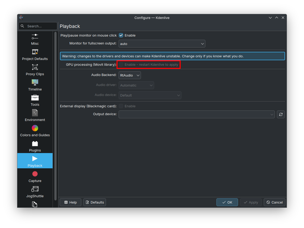

I believe you are referring to this?
That one has been hardcoded to be greyed out since Jan 2024, the comment on this corresponding line in the source code says it all.
But that’s just for playback, not rendering, which should be possible provided you have the required packages installed. I can’t really recall as weirdly they’re not even listed as optional dependencies (in my opinion, they should be), but just try these:

Restart kdenlive if it’s currently running and click Render, the hardware accelerated presets should not be marked as unsupported codec anymore like this:
Thanks for your response, the list of packages you provided was very helpful and I did go ahead and install them. The hardware accelerated presets were not marked as an unsupported codec anymore either which is great.
