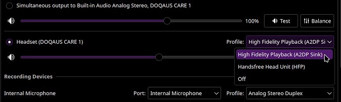

While not seemingly directly related to your question: although the device claims up to 7 devices, I suspect only one of those can use A2DP at a time (keeping your onboard card enabled will allow a second simultaneous A2DP feed to another set of headphones or speakers). But in this case you would get muffled audio, although probably also with some dropouts, if it’s set to HFP.
