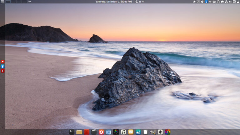

Another X and Openbox based Manjaro spin is Mabox.
