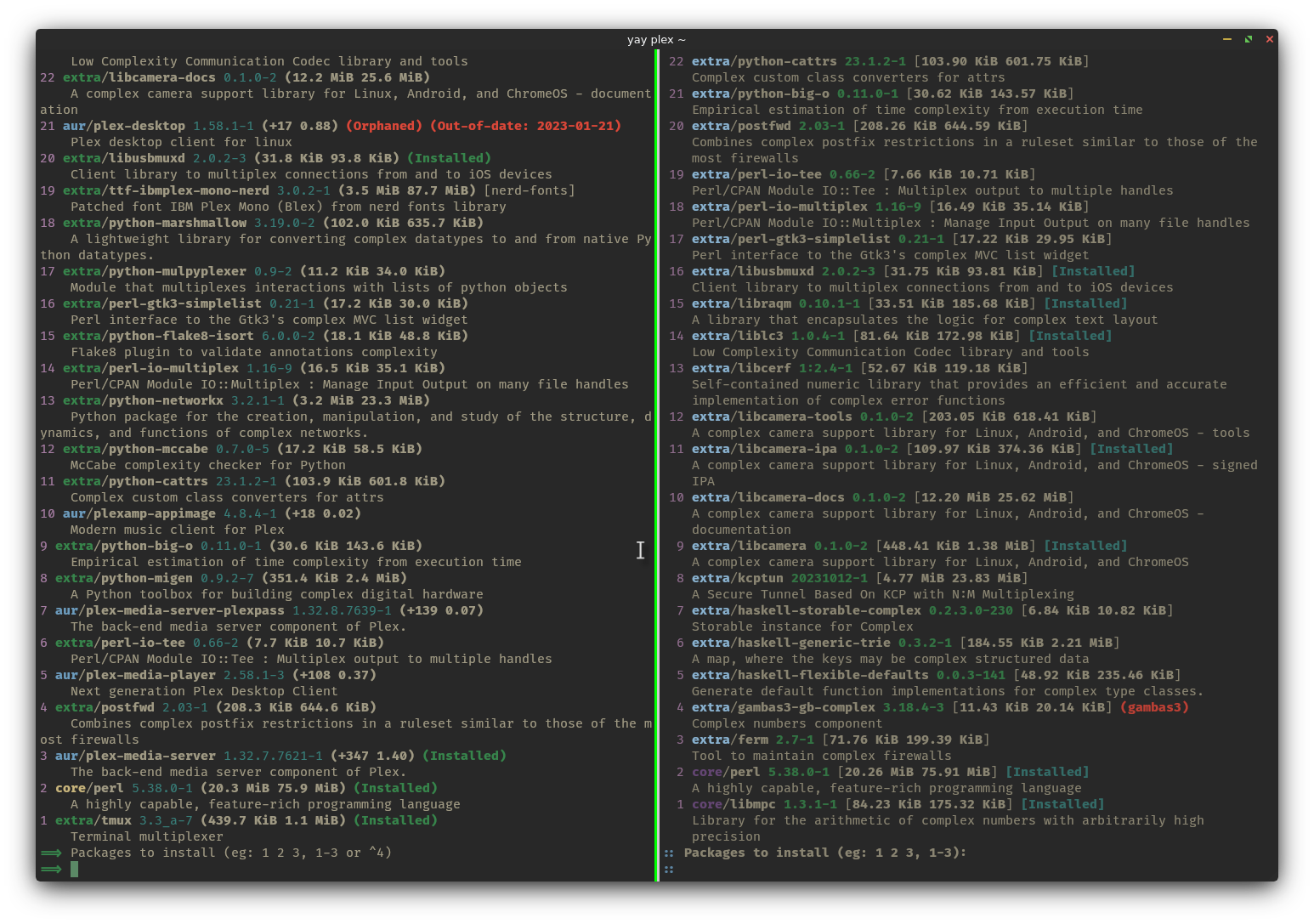

The test is this:
We want to install Plex, maybe media player, maybe the server - so we search:
yay plex and paru plex
Yay brings interesting results, but Paru finds more results from the description than it does from the name - does anyone else have this issue?
Specifically, YAY brought me the server (3rd item) and the player (5th item) as well as pulling in the ‘plexamp’ package and ‘plex-desktop’ at number 22.
Paru pulled in libmpc relevant because of ‘comPLEX numbers’… and a bunch of other spam without actually getting any application with PLEX in it’s name!!!
I tested with the default config - with ‘bottomup’ added, because it strangely isn’t the default.

paru --searchby <field>
but I agree the results are somewhat random
Yes - as I say, I like yay because a lazy search yay plex will find what I want - I’m sure it is defaulting to search the name as a high priority.
I’m confused why paru doesn’t, and can’t imagine why anyone would use paru if it works the same way for them.
When I use paru --searchby name plex I get exactly the same result - it is ignored.

 $ paru search --searchby name plex
1 core/perl 5.38.0-1 [20.26 MiB 75.91 MiB] [Installed]
    A highly capable, feature-rich programming language
I think it’s time to dig into the config - as yay isn’t too great with the default either (the player and server were around result 40 to 50, as with paru).
Maybe there’s an issue with the paru config syntax…
yay:
	"sortby": "popularity",
	"searchby": "name-desc",
paru
       SortBy = votes
       SearchBy = name
Paru ignores it all, mpc still comes first on ‘complex’ in the description.

The additional search command does not exist. Paru searches by default:
or with regex: paru -x '^plex'
It is only for AUR search, not for repository search.
I like to use paru -Sss " plex" to show URLs and sources.
It would be okay if it would return results from ‘name’ before returning other results from ‘description’.
The annying part is that I don’t seem to be able to pass a flag to search ONLY in the name.

paru -x '^plex' is closer - but excludes repos.
It’s a bit sad that pamac is the only tool to search them all (including flatpaks).
This is quite right - but also slightly annoying - but yes, as with ‘yay’ before I edited the config, the result would be around 46-48 in the running (with plex in the name).
PamacGUI gets Plex (flathub) first, then Plex-HTPC (Flathub) followed by AUR ‘plex-media-server’.
I can’t figure out why I can’t do:
paru --searchby name "plex"
This searchby limitation is only valid for AUR package, for repo-packages, it searches in name and description.
From their GitHub:
Repo searches are done by name, desc, provides. This is what pacman does and it can’t be controlled. Pacman -Ss is also regex by default. --regex and --searchby only effect searching the AUR.
(Source: Looking for packages only by name in AUR ¡ Issue #1036 ¡ Morganamilo/paru ¡ GitHub)
The output of paru -Sss " plex", plex-media-* (3. entry and 5. entry) appear in the list .

Then I think I need to delete the config because I got this:
paru -Sss " plex"                  ✔   9:03:17 pm
extra/ttf-ibmplex-mono-nerd 3.0.2-1 [3.47 MiB 87.66 MiB] (nerd-fonts)
    Patched font IBM Plex Mono (Blex) from nerd fonts library
    URL     : https://github.com/ryanoasis/nerd-fonts
extra/ttf-ibm-plex 6.3.0-1 [0 B 57.20 MiB] [Installed]
    IBM Plex Mono, Sans, and Serif
    URL     : https://github.com/IBM/plex
But yes, works nice with autocomplete. As does Pamac (though sadly only the GUI can pull in Flathub results).
They are in the repository that has a higher priority than AUR in the search list. :man_shrugging:
I got a message from the developer saying to try paru -a Plex, however this just filters aur.
