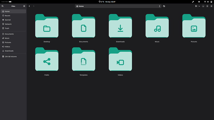

Update "Adwaita-maia" from the adwaita-colors package
A while ago I recolored the icons of this theme to match the Manjaro colors, which got added into the repos as a patch, I believe. I suggest the maia icons are updated to more closely resemble the Adwaita style:
Using the maia accent as dark color and #b9e2da as light, which I can change to something else.
Here is the theme: https://drive.google.com/file/d/1gKUx_rnm0VuOwELvZIE7H65GrWiSmgTl/view?usp=sharing
Morewaita should be installed so it falls back to it
And here is the script that I used, though it’s AI generated, but I troubleshooted it
Tell me if you see issues with icon colors

I adapted the script and applied the changes with adwaita-colors-icon-theme 2.4.2-2 in the Manjaro unstable branch.
Thank you, worked for me
Actually wait, I think I might have given a wrong script, since not all colors apply correctly
This is my original script which prompts the user for some things adwaita-colors-icons-customizer/adwaita-colors-icons-customizer.sh at main · pacu23/adwaita-colors-icons-customizer · GitHub, I asked AI to remove the unnecessary things but it seems to have done whatever it wanted to
Maybe now it’s right?

Tested, seems to work
Applied with 2.4.2-3.
