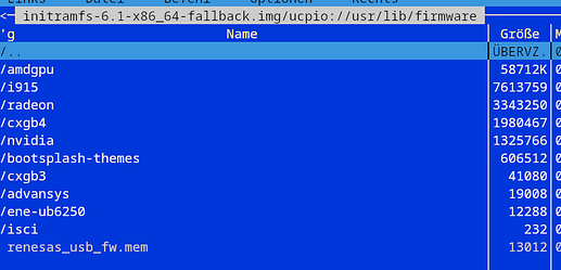

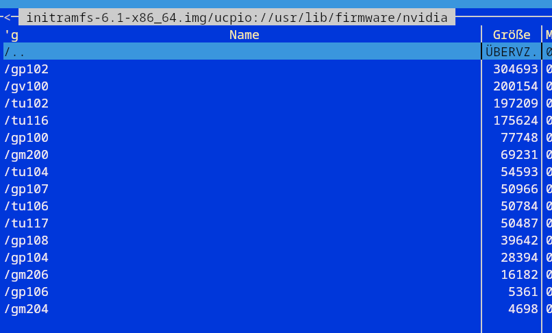

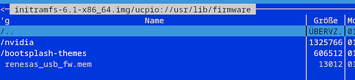

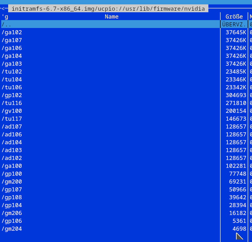

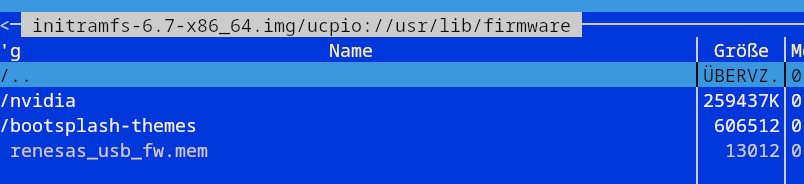

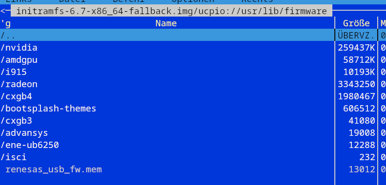

Comparison with mc
6.1:
1.3M
6.7:
259.4M
So there is a folder with 258M for nvidia, which was not this big with 6.1 :see_no_evil:

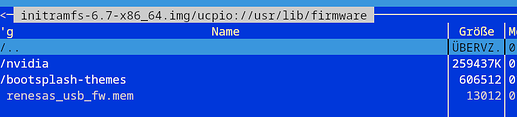

And not only in fallback initrd !
6.1:
1.3M
6.7:
259.4M
:footprints:

Anyhow, either way, diffing 6.6 and 6.7 shows /usr/lib/firmware/nvidia/*/gsp to be the only difference, which is in agreement with that post, whatever gsp is in this context.
So, for NVIDIA is clear, I’d like to see you with intel/amd etc. do something similar.

Those who still wonder about the initramfs file size: https://www.phoronix.com/news/NVIDIA-Big-GSP-Firmware-Dump. So mkinitcpio and dracut are affected by this. If you live in Ubuntu world, you wouldn’t have a problem as Canonical is bundling firmware already way longer than upstream does now. Do you need that firmware in your initramfs? Most likely not. It is only designed for Nouveau drivers and nothing more. So even if you use the proprietary drivers, you don’t need that firmware. What is it for? Eye-Candy and other nonsense to make the boot experience smooth with Plymouth and Co.
Temp solution: get rid of kms, maybe plymouth and let the quiet flag do all for you. Most likely you will see a vendor logo on your UEFI system without the fancy progressbar plymouth would add. You can also just get rid of kms in the fallback image or disable fallback completely.
kms Adds GPU modules to provide early KMS start. Additionally adds modules that are required by privacy screens built into the LCD panel of some laptops.
Manjaro added kms just recently with Calamares on 23.3.1 install medias. Before that we didn’t use it on standard installations. Arch had it added since a year: Update mkinitcpio.conf (!126) · Merge requests · Arch Linux / Mkinitcpio / mkinitcpio · GitLab
More info on it here: kms hook increases the initramfs size heavily starting with 6.7 kernel (#238) · Issues · Arch Linux / Mkinitcpio / mkinitcpio · GitLab
