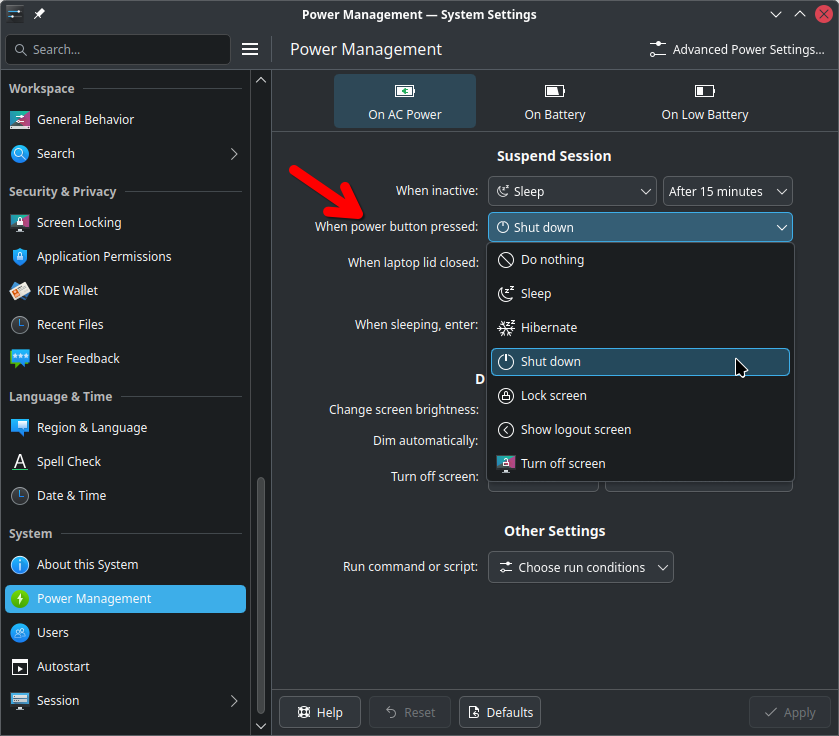

Where did you set what you call “GO TO STANDBY"? What did you set here in this setting?

Yes, exactly. I set “When power button pressed = Sleep”
