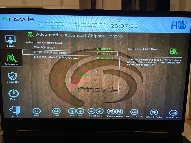

Hey mithrial, I checked the BIOS and haven’t found any settings related to mDP port. Other settings related to secure boot etc. are already disabled. Also note that I can’t have an external monitor connected through USB-C for some reason, so it’s probably not mDP-specific.

I meant this
Why doesn`t my monitor show a picture on the USB 3... - MEDION Community
Oh, thats very interesting!
Unfortunately, my BIOS looks very non-standard, which gave me some headaches before already with disabling secure boot. Can’t seem to find that option.
