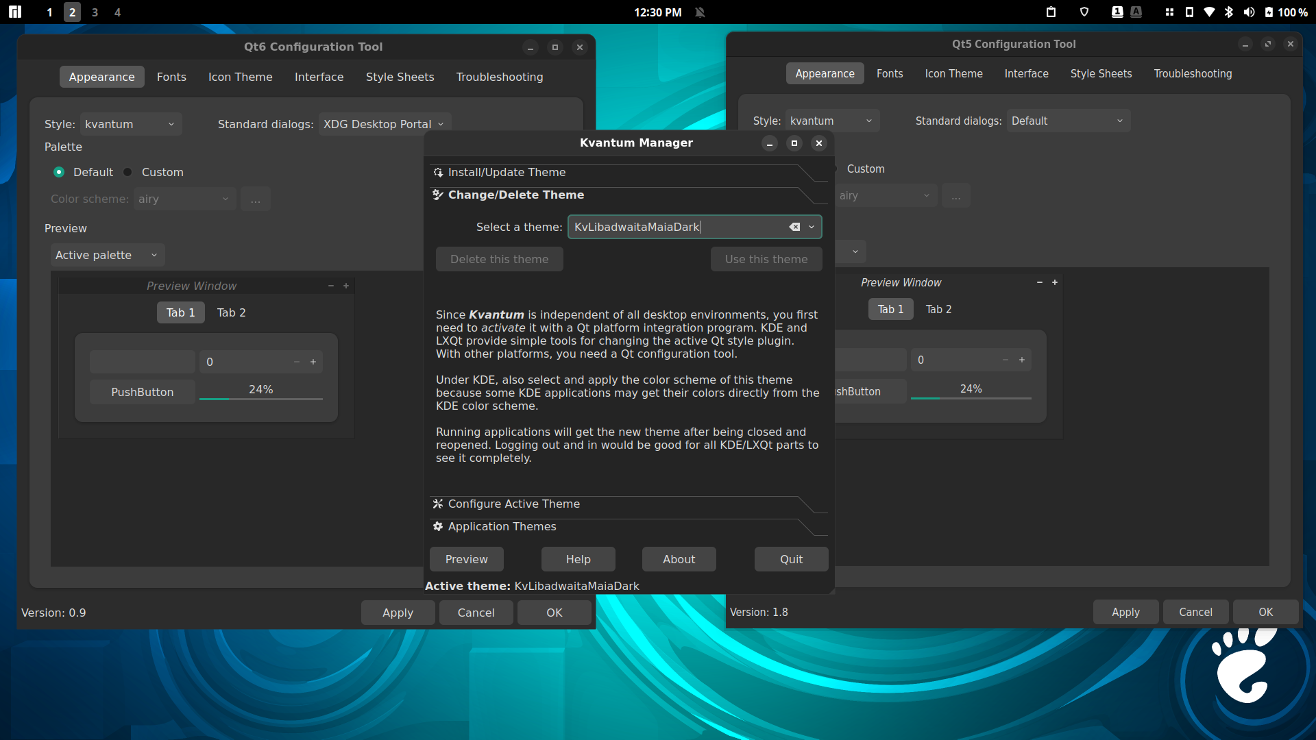

Scaling works fine now, but I noticed that I get some ugly window decorations then:
It doesn’t matter if I activate the Kvantum themes or leave it on the default ones (actually, I don’t see a default theme on the Qt6 configuration tool).
The window decorations look exactly the same for Qt5 based apps.

kvantum doesn’t set window decorations; it only concerns itself with the application appearance. Furthermore, Wayland uses client-side decorations, which means that the window decorations depend on the application itself and are not managed by the window manager.
Try setting your qt applications to use the Adwaita style, which is what GNOME uses.

kvantum does not handle window decorations. It only handles the appearance of the application itself — i.e. the toolbars, progress bars, scroll bars, buttons, item lists, et al.
Window decorations are managed by the window manager, or — in the event of client-side decorations — by the application, in which case the application will use the default window decoration for the chosen theme.
Wayland defaults to client-side decorations, unlike in X11, where the window decorations are (normally) handled by the window manager.
Client-side decorations usually means that the window won’t have a title bar with window operations buttons for closing, minimizing and maximizing. In an environment with client-side decorations, those buttons are displayed in the toolbar of the application instead.
The downside of this is that if the application crashes, then you cannot close its window anymore via the “window close” button, because this button and all clicks on it are supposed to be handled by the application that has just crashed. With server-side window decorations on the other hand, the control of these buttons still lies with the window manager, and thus the window manager can still destroy the window of a crashed application.

I have the strong feeling, that those (fallback) decorations come from somewhere else, because they are completely unaffected by any theming.
Why, yes. The KDE Frameworks do allow for individual components of the built-in Breeze theme to be stylized differently.
I suppose so, but this would have to be done through the qt5ct/qt6ct modules.
The application, yes, but not the application themekvantum only handles the application theme. But the window decorations in your screenshot are not from the built-in Breeze theme — they’re from one of the many macOS-style Aurorae decorations at store.kde.org — which means that you must have installed them yourself in some way.
In Plasma proper, there is a button for getting new “things” — depending on the page in System Settings that you’re looking at — from store.kde.org. Window decorations downloaded this way are stored in ~/.local/share/aurorae. Maybe you can look around in there?
