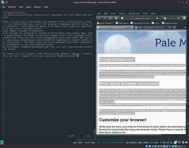

Just booted the i3 minimal iso - connected to the pi I have running ubuntu - fired up vim on ubuntu.
Then I opened palemoon and copied the first two paragraphs. I then pasted them into vim using Ctrl+Shift+v. As this is done on a Manjaro i3 ISO - I am fairly certain your issue isn’t related to Manjaro but rather is local to your system - what it is - I have no idea.
Sreenshot
