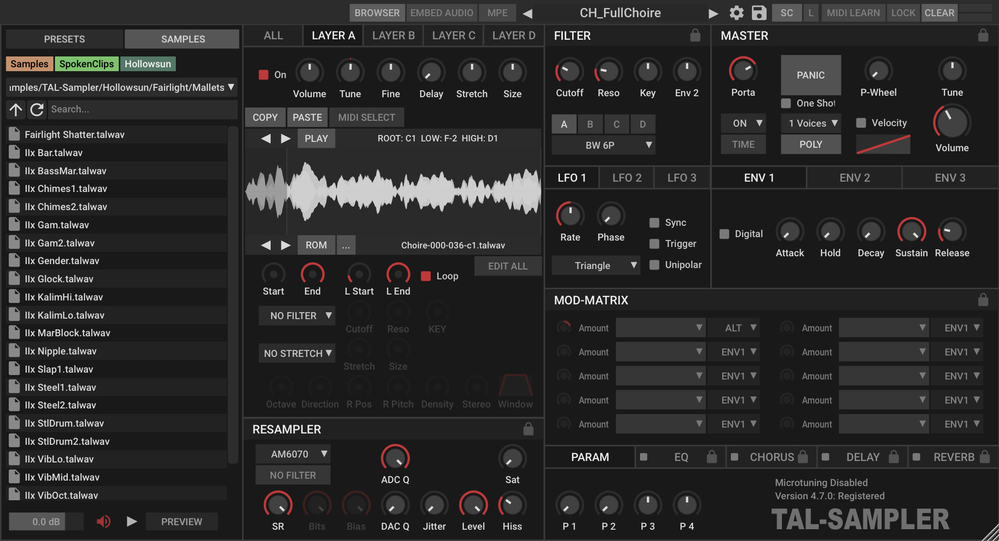

Good afternoon. I am marking this as solved. I am probably going to buy tal sampler:
The author of TX16w apparently does not want to have his software repackaged . Thank you to all of the contributors. I am now able to install packages from the AUR using the terminal :slight_smile:
There are many other samplers available from Manjaro repositories and AUR
Thank you, I have found the one I want, I think :slight_smile:
